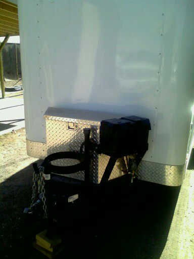

Postby Javier_Pacer » Thu Jan 17, 2013 10:03 pm
I mounted a tongue box on the front tongue and build a frame high for battery to be mounted and tongue box cover side lip locks black battery box cover from having access to battery unless aluminum box door is open.

Postby Javier_Pacer » Fri Jan 18, 2013 2:10 pm
For a Cargo trailer Battery mounting it might not care, but for a teardrop "You bet ya'll".
I will try to post pic of tongue battery mounting.
Javier_Pacer
Posts: 29
Joined: Wed Jan 09, 2013 5:59 pm
Re: Mounting battery under?
Postby Javier_Pacer » Fri Jan 18, 2013 4:29 pm
More tongue mount pictures on album.
