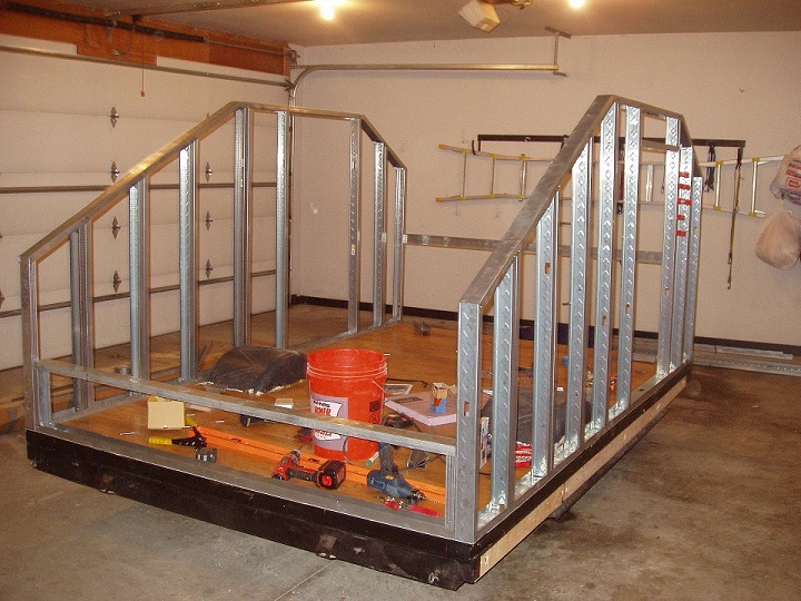

I've actually been researching this a lot and everyone advises against it... I on the other hand, have decided to take a stab at it and so far so good. My trailer is a bit oversized (About 7' X 11' and tall enough for me to sit at the U-shaped dinette), so I'm trying to make it as light as possible but with the best possible insulation.
I am using 2 1/2" studs but am butting them back-to-back to make I beam studs. I'll be sliding 2 1/2" rigid foam insulation between each set of I-beams and then wrapping the whole thing in 1/4 rigid foam, for a thermal break between the metal studs and the outer plywood skin. Then on top of that will be my 1/2 hardwood skin.
When I initially built the frame I screwed everything together, but have been gradually removing the screws and replacing them with pop-rivets.
It's really overkill but it will be very light, very ridged and extremely well insulated when all is said and done...
I've attached a Pic.
