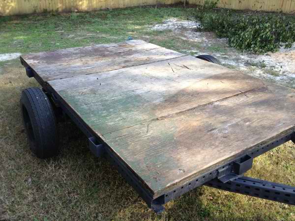

Postby Irmo Atomics » Tue Jan 29, 2013 6:39 am
Hey Mezmo, there's one for sale in the COLA Cl:
http://columbia.craigslist.org/for/3535012018.html
unistrut trailer.jpg (67.63 KiB) Viewed 632 times

For something stationary I thin UNISTRUT is a wonderful idea.... For something in motion I'm not so sure... IF direct bolt & nut everything maybe, but if you are "clamping" unto "U" channel I thing the twist and flex of going down road is eventually going to "work the clamps and things will start to loose its rigidity (loosen)...
