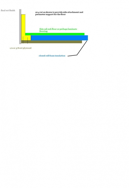

Postby bobhenry » Fri Feb 01, 2013 10:44 am
Plain old plywood and plain old 2x4 spf.
Here is a senario that I have used and it might be of some interest to you....
Re: Suggestion on type of wood for floor base?
Postby bobhenry » Fri Feb 01, 2013 11:03 am
Here is a slightly different version I use on my 4x7 build.
