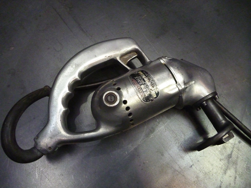

working with aluminium isnt too bad, you can get away with using shears and a router with a flush bearing trim bit to do most of the work. It is expensive however.
I was lucky, picked up an ancient black and decker sheet metal cutter like this
Cuts through it like butter.
And with alu, you can hide any rough edges or cuts with the trim.

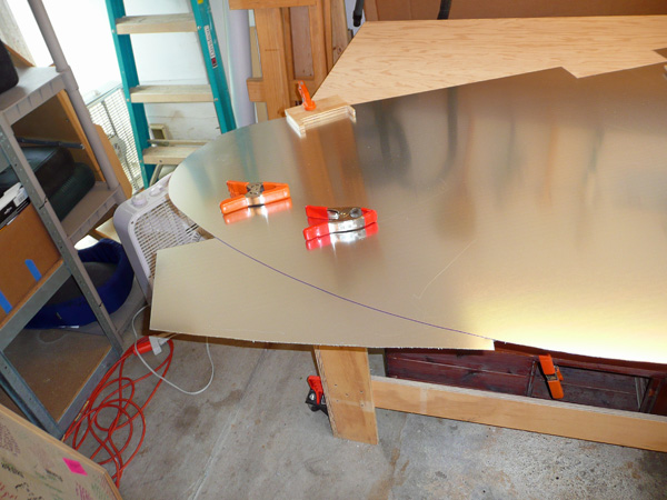

Regarding the aluminum sheeting, here are a few tips:
1. Take your time.
2. Wear gloves and goggles - cut edges can be sharp and aluminum bits fly everywhere.
3. If you don't want scratches, buy aluminum with protective plastic sheeting and use painters tape to mask surfaces where cutting tools ride.
I cut my sheet aluminum using electric shears, router with carbide bits, table saw, and jig saw. The jig saw was by far the easiest to control. In the picture below, I was using a jig saw to cut the aluminum for the sidewall. (I guess this brings up another tip. You'll see there is no masking in the picture. The reason is that I was cutting on the back side of the aluminum so an scratches wouldn't be seen.)
Take care and don't fret about cutting aluminum. It's a little scary but not that hard to do.
