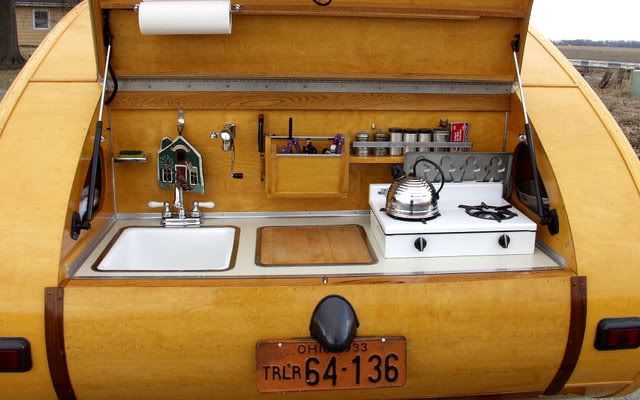

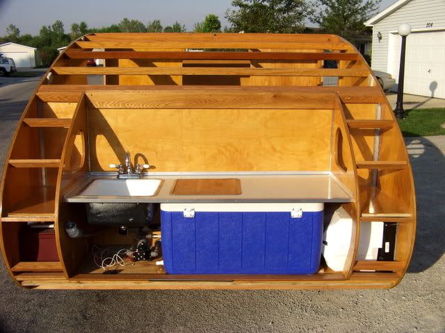

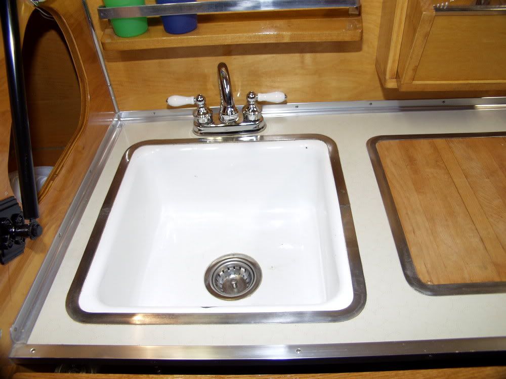

Postby 48Rob » Mon Mar 11, 2013 6:49 pm

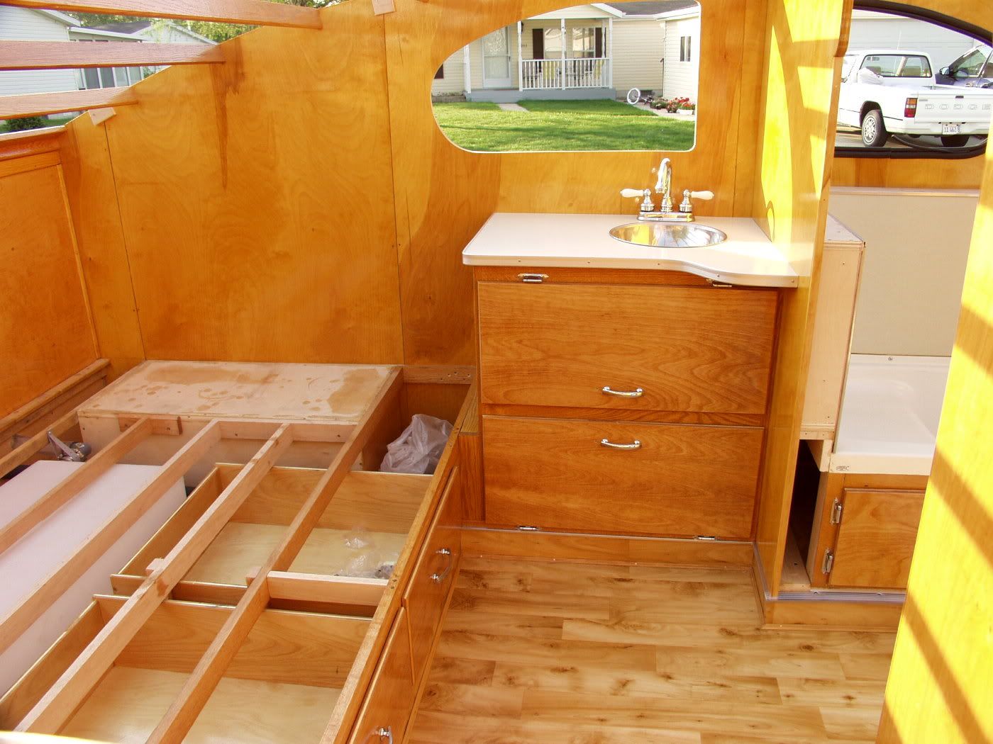

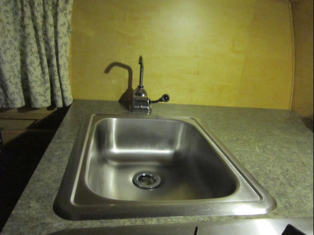

Postby Shadow Catcher » Mon Mar 11, 2013 8:02 pm
I cant show pictures of the tank as it is a 16 gal between the frame rails. The sink has a pull out sprayer faucet.
100406

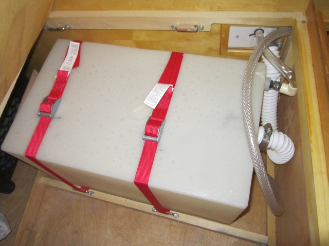

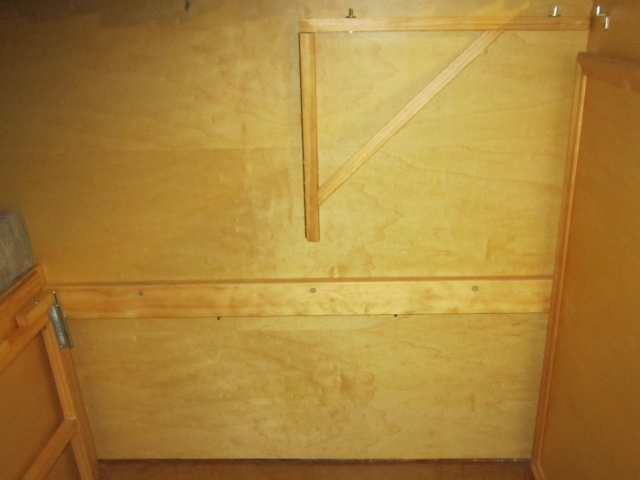

Postby S. Heisley » Mon Mar 11, 2013 9:27 pm
Mine is probably the simplest set up shown so far; but, sometimes, “simple” makes the brain’s “lights” come on:
The water tank is 12 gallons. The clear tube is for air; the white, is for water intake; the clear, reinforced tube is the actual water line.
Water line runs from the bench to the sink cabinet under the bed’s foot support board.

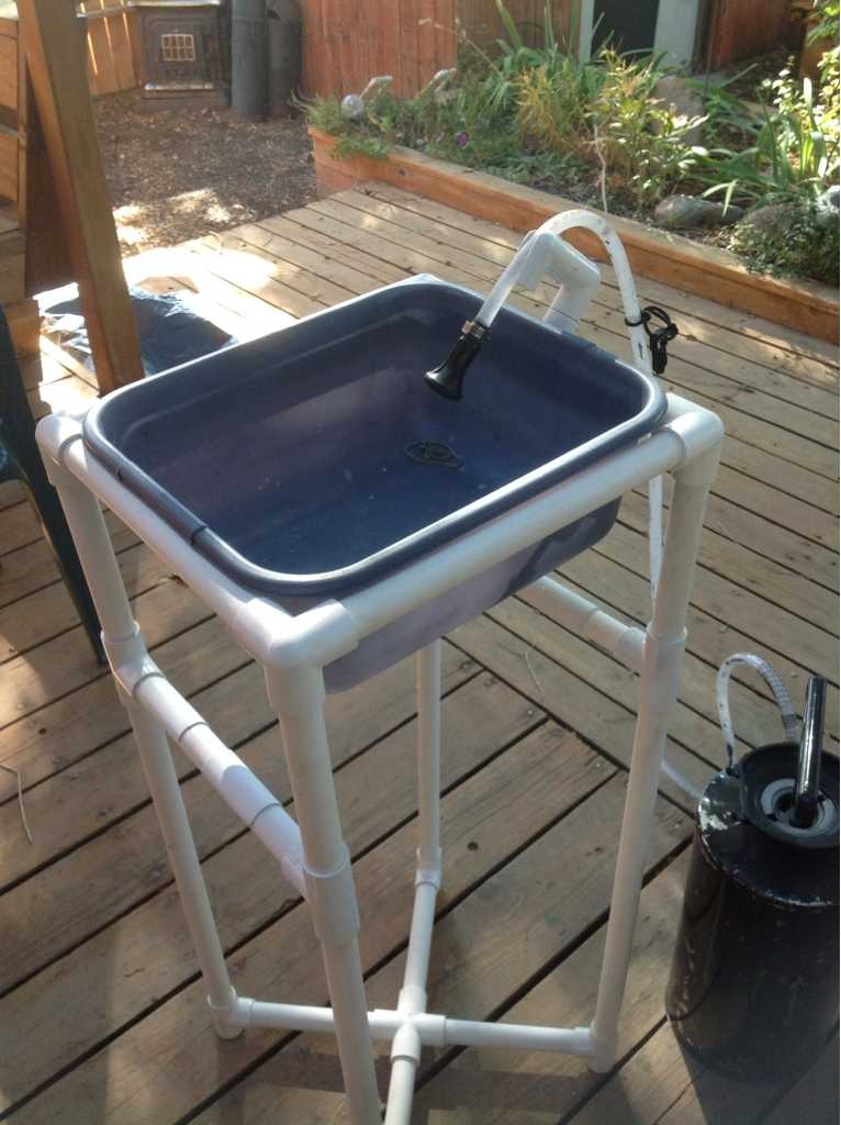

Postby Wolfgang92025 » Mon Mar 11, 2013 10:47 pm
A plastic dishpan and a 5 gal blue jug is it for me.....

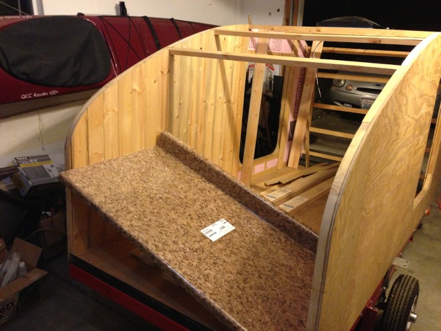

Postby The R/C Man » Tue Mar 12, 2013 12:32 am
Thanks for the great images and ideas everyone!
So I am looking at using a Moen 15" x 15" sink with a single European style faucet, soap dispenser, Flojet pump and a 10 gallon tank.
I am also planning to put the adapters through the wall for inlet and drains as well.
Below is a cell pick of the countertop I just bought from Lowes. It will need to be trimmed down a couple inches to fit but I think it will work well.
Teardrop Countertop .jpg (105.01 KiB) Viewed 3353 times

Postby nevadatear » Fri Mar 15, 2013 7:23 am
+1 becky. We use the same set up and it works for us. We have our water in a water drawer, however we now have a hot water set up via a weed sprayer i use for my showers that i have dual purposed as my dish water sink too. Dishpan holder is my repurposed pvc garbage bag holder than now also holds a dishpan. Can't wait to try it out at the Dam!
