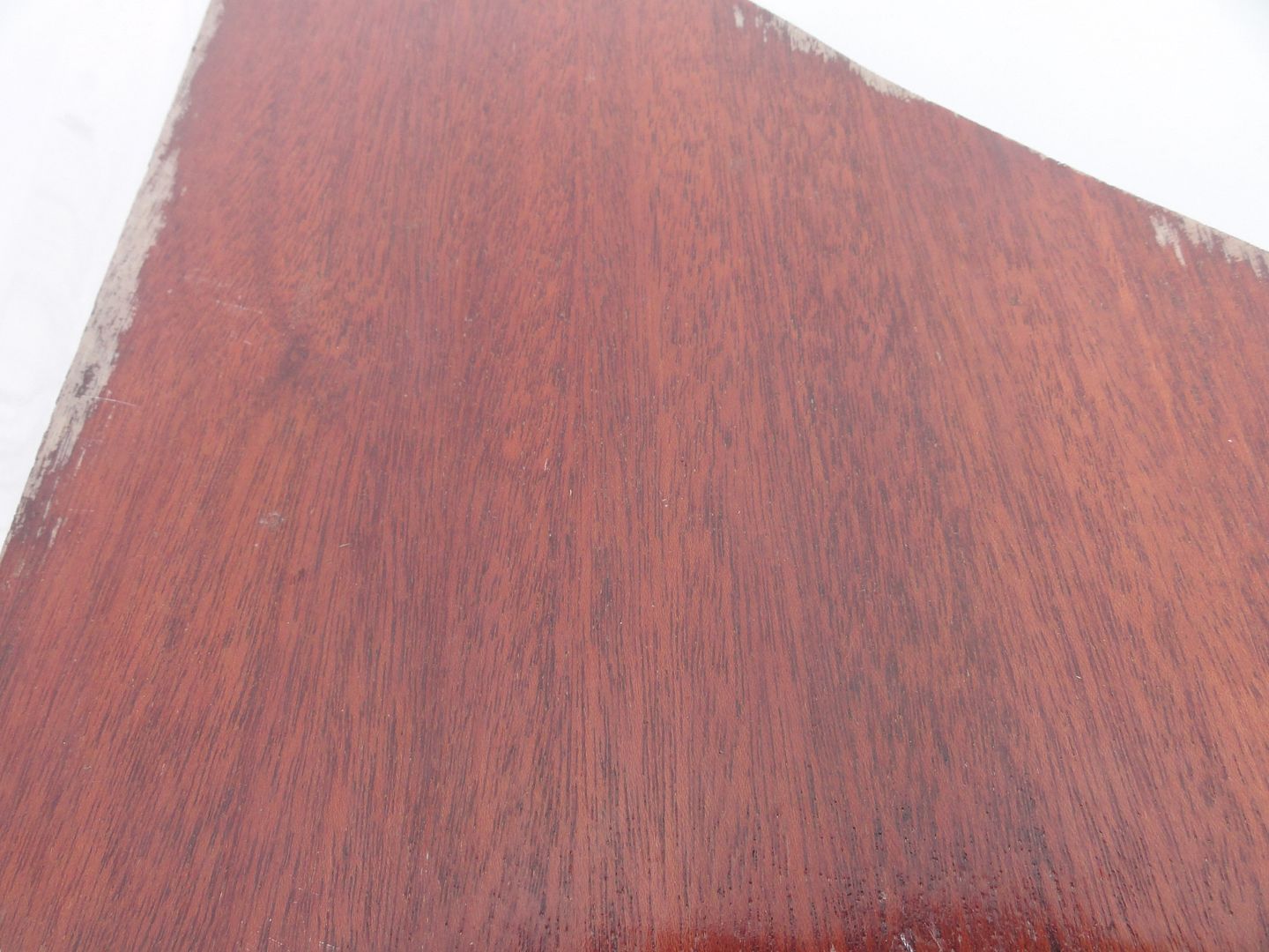

This sample was made before I used it on the trailer. It has been left out to the weather since last April, almost a year. It has 2 coats on the mahogany side and no finish on the Maple side. It has laid on the ground, been rained on, sun baked and been under the snow. This is what it looks like today.
