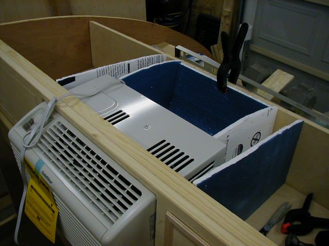

Postby asianflava » Thu Mar 14, 2013 2:20 am
As long as you let the condenser side get good air flow, you shouldn't have a problem. Mine is mounted high in the cabin, I ducted the air to pull cool air in from the galley (the sides) and duct hot exhaust out the top (the center). The center is a like a ramp that curves up, there is space underneath the ramp where the intake duct sits.

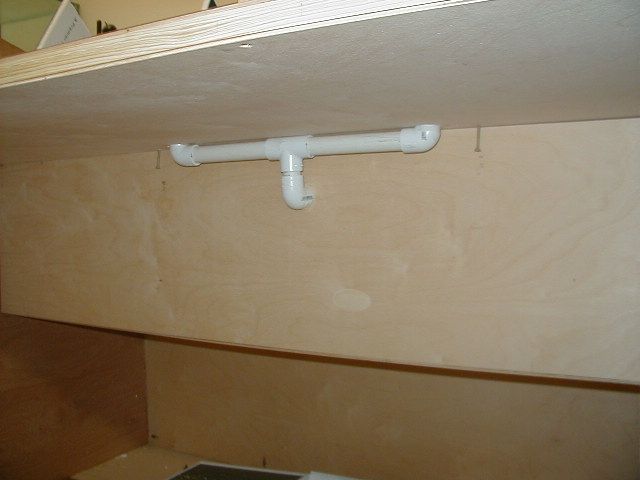

@asianflava, where does your condenser drain run? I don't see a way to drain the water from the condenser.

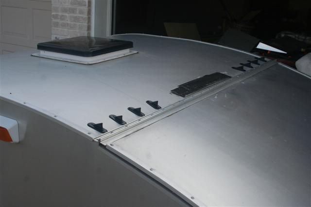

Postby asianflava » Wed Mar 20, 2013 1:59 pm
GuitarPhotog wrote:@asianflava, where does your condenser drain run? I don't see a way to drain the water from the condenser.
<Chas>
:beer:
It kinda sits in a shallow pan, there are condensation drains on the two rear corners. I can always tilt the trailer back, but Left to Right is more difficult so I just put them on both sides. They join and drain out the bottom, you can just make out the elbow on the interior pic. The a/c unit is also like a pan, the drain on the back isn't all the way to the bottom so it still collects within the unit. I need to remove the unit and cut notches or drill holes in the bottom of the unit.
clintstuckless wrote:
So does that mean you have a roof vent above the unit?
Yes there is a vent on the roof. If it rains, the pan catches it and it drains thru the condensation drains. If it will be a monsoon or while driving, I just put a piece of duct tape on it. I was going to make a reverse scoop for it, but never got around to it. I have the same vent in the galley to draw air in.
