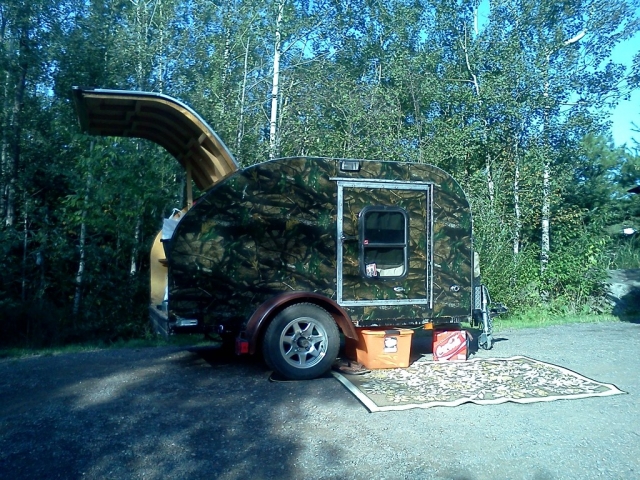

I had to redo my Tear due to water damage. I decided to use fiberglass epoxy but instead of using fiberglass cloth, I decided to use a cloth with a camo pattern.

TPMcGinty wrote:I had to redo my Tear due to water damage. I decided to use fiberglass epoxy but instead of using fiberglass cloth, I decided to use a cloth with a camo pattern.
Looks good! How well has it held up?

Martinjmpr wrote:Looks good! How well has it held up?
So far so good. Last year was the first year I used it since the repair. I had to put three coats of marine varnish over the epoxy for UV protection. I also store the Tear in my garage. I wish I had used the epoxy to seal from the beginning. I would have loved to keep the woody look. I put the camo cloth on to hide the visible water damage.
