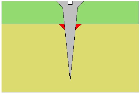

I was taught by a guy that put deck fittings on racing yachts (which is a pretty severe duty) that the obsessional way of sealing them was to intentionally put a countersink in the (yellow) deck material before screwing/bolting the (green) deck fitting to it. This gives a ring void around the screw (shown in red) into which the sealant can go and provide a long-lasting seal.
Bolting two flat surfaces together is pretty hard on sealants as there is only then a thin layer between the two surfaces.
