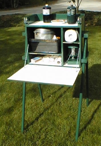

Would a chuck box work for you?

Irmo Atomics wrote:Would a chuck box work for you?
Wow that could be a grand idea. Would the main structure be any weaker by not having a bulkhead?
Do you have plans for this? my Dad made one for Mom 50 years ago from plans or a kit and now I want one to add to the tear.
removable so I can put it at the end of a picnic table.
Karen
nhstt
Posts: 153
Joined: Sat Jan 26, 2013 1:31 pm
Re: Removable Galley
Postby LarryJ » Tue Apr 30, 2013 3:37 pm
nhstt wrote:Do you have plans for this?
A simple google search for 'chuck box' or 'patrol box' will find many free plans. Most plans call for 3/4" ply - if it will be in the tear most of the time, and only be moved from the tear to a nearby table, then you can get away with 1/2" (to save some weight).
