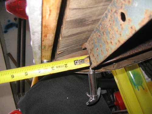

I picked up the wood for my T.D. today. I'll be putting down the floor and cutting the sides tomorrow. :hammer: When I disassembled the old trailer I didn't take note of how far the floor extends beyond the rear most part of the frame :oops: . If anyone knows what this distance is I'd sure be glad to hear from you.

Postby Ma3tt » Sat Oct 22, 2005 11:39 pm
The floor in my Kit goes all the way to the end. Just Kidding.
Seriously Ok I will take some pictures of my frame and stuff in the a.m. for you. Is there any other areas of concern? Sides? Misc?

Postby retrocentric1 » Sun Oct 23, 2005 12:12 am
Hi.. My main question is does the floor stop right at the end of the frame or does it extend beyond? I don't remember, as I did the disassembly about 3 years ago, then the project got put on hold.

Postby Ma3tt » Sun Oct 23, 2005 10:59 am
Sorry had to wait for the coffee to kick in a bit........
It looks like 2 3/4" Off the rear of the frame
and a side view... That hangy down part is a latch for my hatch
Mine is a '47

Postby angib » Sun Oct 23, 2005 11:06 am
Ma3tt wrote:Mine is a '47
And, while you're down there with a tape, is that 2"x1"x3/16" channel frame?

Postby retrocentric1 » Sun Oct 23, 2005 2:26 pm
thanks for the pics, that helps alot. Nice looking tear by the way.
Yeah, the frame is made of 1x2x3/16 inch channel iron.
