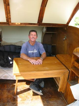

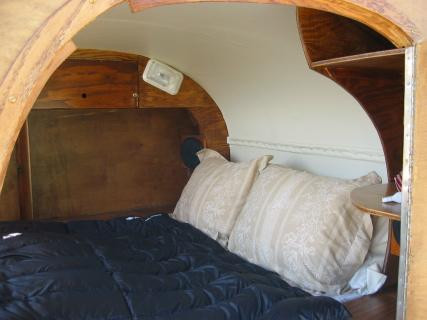

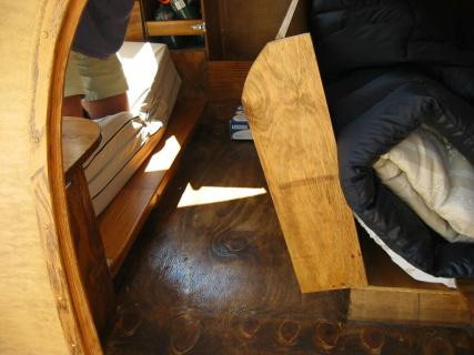

Postby kurtibm » Tue Oct 25, 2005 1:32 pm
angib wrote:
bigrod wrote:.....probably in the 6 x 12 size.....
I forgot to point out that the bed in the Kampmaster is transverse. So you at 6ft 3in lying across a 6ft wide trailer isn't too good!
Andrew
The bed design can changed to be put in length-wise, as was done in mine - yes, it eats a bit further into the galley area, but the elbow room is a Godsend. Using a futon, or multi-fold foam mattress, a small sofa (and table) are possible; as is "basement" storage.
http://www.tnttt.com/gallery/image.php?image_id=3512
http://www.tnttt.com/gallery/image.php?image_id=3513
http://www.tnttt.com/gallery/image.php?image_id=3514

Postby angib » Tue Oct 25, 2005 5:10 pm
kurtibm wrote:The bed design can changed to be put in length-wise, as was done in mine
Very nice. When lying in bed, are your legs (well, feet) between the wheel-boxes?
Andrew

Postby kurtibm » Tue Oct 25, 2005 5:17 pm
Andrew
Part-way... yes.
