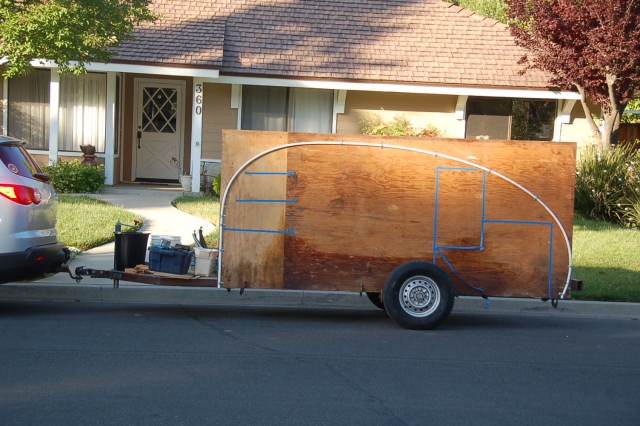

Now the fun stuff. I've cleared off my trailer frame and have lofted up the profile and all of the critical dimensions. I've worked out all the details as to how I'm gonna fabricate everything and have purchased most of the materials.
Here's a view of my Traverse and trailer:
Here's a close up of the trailer. I don't plan on having any cabinets inside, just some simple shelves for stuff. The shelves are marked off with masking tape on the front of the cabin. I love Rubbermaid bins for storing food, pots and pans, utensils, and other stuff. The bins are weatherproof so they can be left outside, they're easy to move around, and you can dump more stuff in a bin than you can stuff in a cupboard. I plan on having a storage compartment between the cabin and galley and the door for it is also marked off with masking tape. You can also see the counter in the galley marked off:
When we had the boat we loved having a real oven. We made pizza, baked apples, and all manner of stuff. So I bought a small RV range/oven and plan on installing it in the galley. Just like home.
