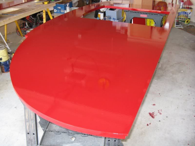

Postby planovet » Tue Jun 04, 2013 5:30 pm
I used Baltic Birch for my sides. I put down 2 or 3 layers of CPES and then painted it. Three coats of primer and five coats of Valspar Supreme Acrylic Enamel.
It's been 4 years and no problems so far. Most people look at it and think it's fiberglass, they usually can't believe it's painted wood :D
ImageMark (& Cindi)
planovet
The Cat Man
Posts: 5583
Location: Plano, Texas
Re: walls and roof coverings
Postby Oldragbaggers » Tue Jun 04, 2013 9:05 pm
Planovet, that is one slick and beee-oooo-tiful paint job.
Postby planovet » Wed Jun 05, 2013 3:32 pm
Oldragbaggers wrote:Planovet, that is one slick and beee-oooo-tiful paint job.
Thank you. A lot of work went into that. I guess that's why it's still holding up after 4 years of use.
As far as Mike's delamination, I have no idea. I have not seen it in person.
I used CPES before I primed and painted, paying special attention to the exposed edges. The paint I used is actually a trailer paint. I wanted the color of the sides to exactly match the trailer so I used the same paint they used to paint the trailer. It comes with a hardener that makes it glossier and dry harder and faster.
When I painted it, I had no idea if it would hold up or not. But it's a very different paint from the porch and floor paint that Mike used. Apples and oranges...
To make a long story short, you CAN paint a teardrop and have good results.
