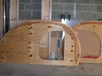

You shoudl be able to slide the plywood between the spars from the back(just over the spar for the hatch and under the rest of the spars) it should slide right in. I did mine like Steve F. did his and put a ledge in that the plywood sits on and then put the spars on top of that. See my 'www' and or go to the Hall of Fame and see the the top row on the right (Steve Frederick's Stripper TD).
Here's a pic of the ledge on mine during construction
Hope this helps.
