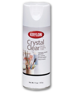

I went the route of poly mix (base coat)/ tractor paint (top coat) over plywood. I even used Silo paint (aluminum heavy-duty) for the front, roof, and sides - for weather resistance and reflectivity. All plywood edges (exposed plys) were either vertically oriented, shielded by a rain deflector (hatch opening cover), or coated with PL adhesive (waterproof when dry). then they were painted over. The holes in the roof (where 1/4-20 bolts bolted walls to roof, to cinch them together as well as PL adhesive) were coated with PL, and capped with stainless acorns. They never leaked when poly mix was liberally splashed over them, nor when painted over. Still, more sealant was applied. But, the sidewall piercings, both for full thru-wall bolts, and vent and trim partial piercings, were either sealed in the same fashion or were overlooked in the heat of the build. Either way, my initial plan was to go back, after all the poly, paint, adhesive, and thread sealant had cured, and use a clear acrylic or enamel spray to cover all skin piercings (nuts, bolts, screws, washers, et al...). I initially intended to use Krylon Acrylic Clear
http://www.krylon.com/products/crystal_clear_acrylic/, and I tested it when I painted my HHR's wheelcovers 18 months ago. I painted them white, to match the panel van's paint, and clearcoated with the spray. It wore very well. I recently was at Home Depot though, and talked briefly with a Rustoleum rep, who said that their Rustoleum Clear Enamel
http://rustoleum.com/CBGProduct.asp?pid=166 would work as well. I'm leaning towards the enamel, where it will contact the enamel paint, and the acrylic where it only contacts metal. Sound like an OK plan?
