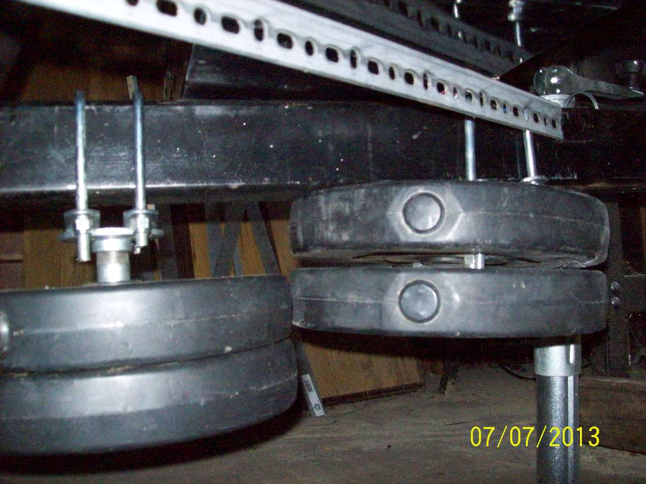

Since I now believe the trailer to be 1360+ lbs, with only 7.3% tongue weight, I figured to throw "lightweight" away, and added another 32lbs to the tongue (2 more barbell weights). Positioned behind the first set of balancing weights, they added 22 lbs at the hitch, changing the tongue to total weight ratio to 8.75%. Still not there.
not pretty, but detachable, and effective

My advice would be to try other means; take the extra weight off the front/stop adding weight on the front and either remove weight from the rear or think seriously about moving the axle rearward.
Either that or shift your consumable weight closer to the axle and let it be. Easy to say, but perhaps hard to do. Just seems wrong to me to add dead weight. :shock: :? :cry: :roll: :o

Please forgive me, in advance, for being a "Gloomy Gus". Adding weights right at your coupler to achieve the right "tongue weight" is IMHO the WRONG approach. Tongue weight is only, again IMHO, an indication that your trailer is loaded in a balanced way that will help prevent the trailer from oscillating when the "stars are properly aligned". The stars being your speed, load, road, springs, tires, trailer balance, and a host of other factors. Generally the closer all of the weight is to the axle, the better. You can't add weight much further from the axle than right at your coupler.
IMHO you need to look seriously at the weight distribution of the total load on your trailer. The closer heavy items are to the axle the better. I agree that moving the axle or serious redistribution of the weight is the right answer. Adding weights near the coupler is at best not a good solution and at at worst a recipe for potential disaster.
We were near a truck towing a trailer with a dune buggy on it this weekend. He was right on the edge at times (beginning to oscillate) and it didn't seem to phase him one bit. I passed him as soon as practical as I doubt he'd have listened to me. I have signaled others over at times and tried to explain the dangers of their behavior. Some listen, some don't.
For your own sake, fix the problem the right way, not by adding weights at the coupler which is NOT going to prevent oscillating.
Again, IMHO, the more tongue weight, the better as long as your vehicle is capable of handling the weight. The further back your axle (with attendant increase in tongue weight) the better your trailer is going to tow.

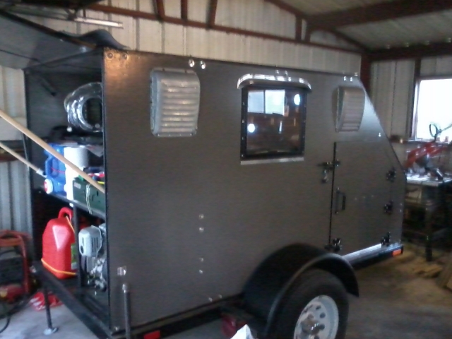

Postby 48Rob » Tue Jul 09, 2013 5:56 am
I'm not an engineer, but 55/45 is cutting it very, very close considering you have a (light) bed in front of the axle and a (heavy)galley behind.
Looking at your pictures, it jumps out at me that the axle needs to be moved back about a foot.
Rob

The real problem is obvious in looking at this pic:
All that weight of generator, fuel, water, and AC all way behind the axle with nothing up front plus a long tongue. I agree with Rob that you need to move the axle back at least a foot to get this load properly balanced.

Try moving the generator from the galley to the tongue. I'd also move the fuel away from the galley if possible, gas isn't the most appetizing odor. Or, if you're set on those being in the galley, put one or two group 27 deep cycle batteries on the tongue. A group 27 battery weighs around 55lb, so they'd add weight very quickly, plus reduce your generator run time requirements, possibly allowing you to downsize both the generator and the fuel.

Guys- the original trailer frame was lengthened by 24" in the rear just to accommodate the 2500watt generator. My error at the start was only adding 12" to the front. As a partial concession to the difference in length (changing the bias to 45/55), the tongue was made much longer and heavier (but obviously, not enough) 86935 . I had no indications that it was unbalanced at first...when the frame and floor were done86942 , it was taken to a scale and weighed (exactly 400lbs), and it towed and tracked perfectly. Later, as I added the upper structure, and the generator, I had a time lifting the tongue and towing it by hand when it needed to be moved...again, no indication of weight imbalance. Then came the day when I brought it home, after the doors and hatch were finished; 55 miles over a mix of bad roads and highway traffic again it was a perfect pull (and it was hard to lift onto the hitch ball (tongue was still heavy at that time). I had a booger of a time unhitching and hauling it into my garage, over a ridge of dirt and 15 degree cement apron. Still no indications of imbalance, front to rear, just heavy! Then the trim out began: I always included the generator (and the A/C almost from the start) in all my plans and calculations, and moved weights around to compensate, and everything hinged on that premise. The heavy fuel jug, and the water jug in the rear came later, as did the battery, but the calculations predicted no major problem. I may never know where my calcs went wrong, but they did. I've already moved the water jug forward for travel, and intend to move the battery and fuel jug (maybe convert to jerrycans flanking the spare tire?) to the tongue as well. The Coleman equipment weight is negligible, so that will stay put. And, I've plenty of side and rear photos in my gallery, but there are a couple that show the front mounted spare and small toolbox 106809 which should demonstrate my trying to supplement the 45/55 balance (I used lightweight angle iron to make the toolbox outriggers, not dreaming that I would have too little weight there). And as I stated before, the spare water and the ice chest were always intended to ride inside the cabin, forward of the center of gravity. I'm going to re-fit the front end, and either build a tongue box around the spare (to secure battery, and maybe fuel cans) or find one that will fit the space there. Either way, more weight will be transferred (and leave some room in the galley for "cooking gear" at last. Sorry, lightweight only, no cast iron. I may end up having to put in a heavier-duty axle, but I do not want to move it rearwards; I've grown used to the stance. Other options still exist to supplement towing stability : single beam weight distributing device, friction or hydraulic sway control, and yes "hidden tongue weights". Guys-I really do appreciate your concern, honestly, but I have to do this in my own perverse out-of-the-box way. I never wanted a "show" trailer, nor cookie cutter design, and wanted the bones and repurposed hardware and improvisations to stick out, by intention, from the first. Here's a confession: if I had an idea, and later found it being used by another, before me, I would go another direction. Just to try to live up to (or down to) my tradition of "southern engineering" (there are other terms for it). I like problem solving, and learning as I go, but I am struggling to keep a promise and a deadline here.
