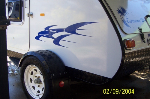

Postby Roo Dog » Tue Jul 16, 2013 7:12 pm
Mark,
Is this what you want.
Powder coated diamond plate.
RD
