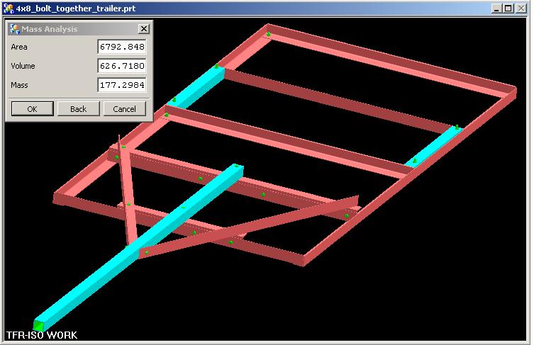

Postby madjack » Tue Nov 01, 2005 12:10 am
Posts: 15128
Postby toypusher » Tue Nov 01, 2005 6:44 am
madjack wrote:Gene, try this one
http://pg.photos.yahoo.com/ph/guffdrop/ ... df&.src=ph
madjack 8)
That's the one I was going to suggest. Mike did some drawings for a angle iron, bolt together frame.
