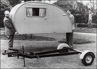

If you build to a sensible weight, I don't think you need any metal in the removable section. Good strong joints in plywood are strong enough as the body is a self-supporting box.
If this could be done 60 years ago, why not today?

angib wrote:If you build to a sensible weight, I don't think you need any metal in the removable section. Good strong joints in plywood are strong enough as the body is a self-supporting box.
While I can't/won't argue your point, my camper is going to be quite a bit bigger than the one in the photo. Plus, not being 100% of the best joining teqniques for plywood I think erring on the side of overbuilding/caution would be prudent.
