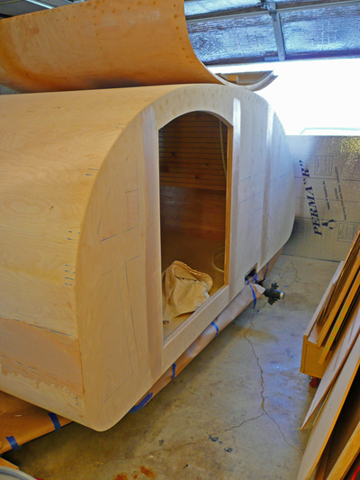

Get laun, it is plywood with all the grain in one direction making it easier to bend. Then, I also had to wet mine down with wet towels and go slow with the bending. "Go Slow" depends on your wood. Could be several hours or several days. I have no patience, so mine was several hours, but I broke a couple pieces and had to start over. :R
Prebend the wood, then after it takes the shape, take it off, apply glue, and clamp or strap it down again until the glue sets. Here is some pictures bending laun to my hatch.
And a broken one on the same 19-inch radius you are working on!
Oh, and I pre bent my interior headliner piece strapped on the outside as a form just to make it easier when I put it on the inside.
