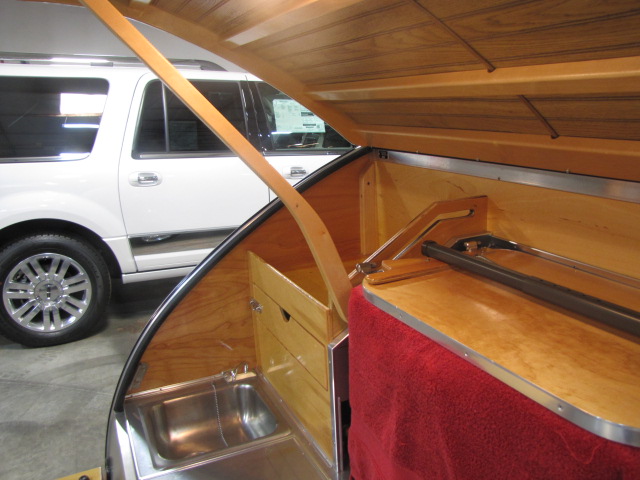

Postby bobhenry » Thu Aug 22, 2013 11:53 am

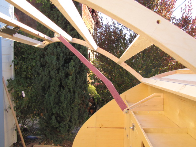

Are we talking about this........????

Re: Camp-Inn style rear hatch support?

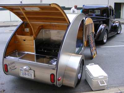

Postby KCStudly » Sat Aug 24, 2013 9:59 pm
Not sure that that is the same. The Camp-Inn looks like it is one solid stick that the lower end rides in a track; open the hatch and the bottom end follows the track until the hatch is all the way up. Gravity keeps the prop at the bottom of the groove, and the angle of incident is what keeps the prop from lifting up in the slot with wind loading. Lift the hatch a tad, push up on the prop to get it started back up in the track and the action of the hatch closing forces the bottom of the prop up into the guide slot.
At least that's what I think I'm seeing.
The one Norm linked to is a multiple piece extending prop rod that telescopes into a locked position with fixed ends.
That Camp-Inn set up is pretty slick, elegant even. With some careful sketching, perhaps a scale model (or two) of the geometry, you could get it close enough to bring it to full scale for some final fine tuning and make that work. Might want to use a good strong piece of select wood for the prop, and probably steam bend it to get the right shape w/o creating weak spots. It will be under a considerable load with leverage and that kink shape to it.

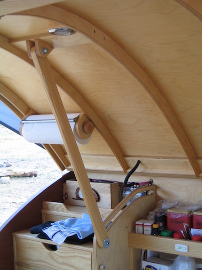

Postby grant whipp » Sun Aug 25, 2013 1:24 pm
This one was on Ron & Pam's stunning woody homebuilt at Walk the Winds a week ago. Might give you a couple of ideas for reference.

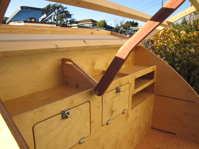

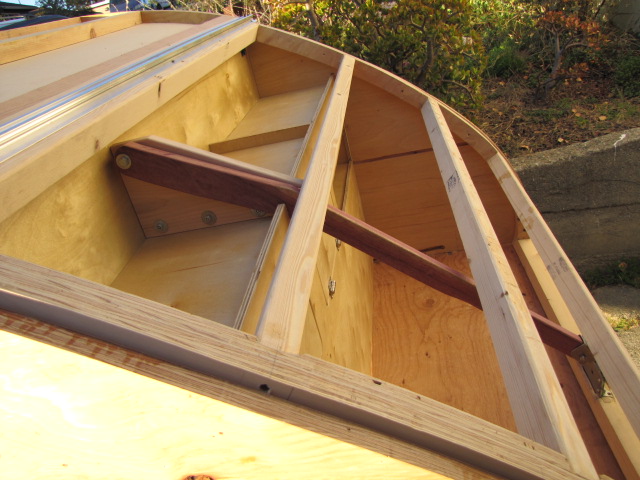

Postby drewh1 » Thu Dec 05, 2013 7:11 pm
Here is mine!

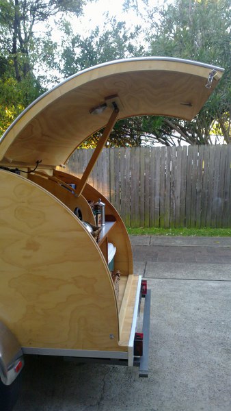

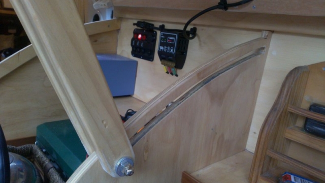

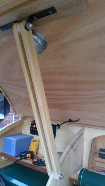

Postby michaelrsydney » Fri Dec 06, 2013 12:33 am
And my interpretation!
I wanted a wooden prop rather than gas struts and the hatch is not so heavy that I need assistance to lift it. I found that a single prop worked ok but puts a twisting force on the sliding section so that it did not move freely in the slot. The solution was to make the support symmetrical by having tandem props. The two parts are separated by an aluminium spacer tube, which forms the running surface, through which the bolt goes. The shape of the track is not critical so I simply followed the form of the TD sides.
I think it is important that the slot continues beyond the highest point of hatch opening and the allows the hatch to drop a little so that the weight needs to be lifted while pushing the prop forward to release.
