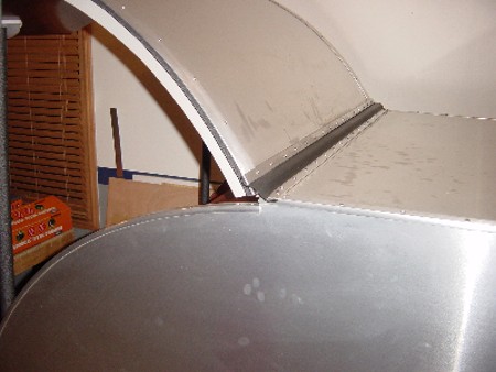

Hatch hinges can be a real can of worms here on the forum.. opinions abound and everybodys got one. I'm building a Woody TD and didn't want a big externally mounted aluminum extruded hinge. I decided to use the McmasterCarr Load rated, UV protected plastic hinge. Shil from Canada has been using one and I believe his only problem was nothing will stick to it and it flexed when screws were put into it... So here a short sample of how I am mounting my Woody version of that hinge in the picture below. Also just in case, and to appease the nay sayer in me, I am going to ad 2 nylon web straps to the underside of the hatch at each end in case it fails at 70 MPH.
Steve 8)

Postby SteveH » Thu Nov 03, 2005 1:33 pm
Steve,
We use hinges like the one in you picture in the control surfaces of our model airplanes, only of course, a lot smaller. They work good, until they break. The thing that gets them is sunlight. It makes the plastic brittle and then they break. I know it looks like a good idea, but personally I would be afraid of it in an application that would get a lot of sunlight like on top of a teardrop trailer. Just my opinion.
