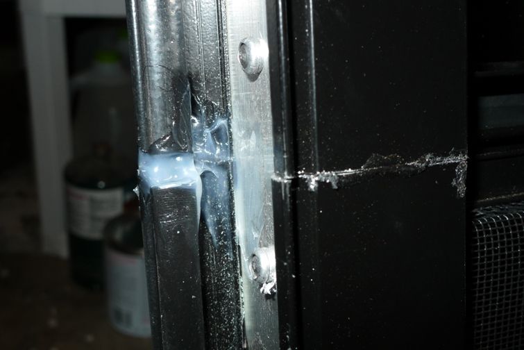

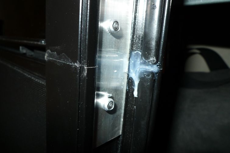

I just took my doors from Frank off of my trailer today to find a leak. Last week I drove through some rain for the first time and my mattress ended up a little wet. Took the trailer to the car wash and had my wife spray it while I was inside. A small amount of water came in through the bottom when she was spraying from the side. After removing the doors, I think I've found the problem. The seal is one piece, looped around. But where the two ends of the seal come together, there is a small gap. The gap is on both doors and about half way up. I'm pretty sure water got through the gap, ran down the inside of the door frame, out the bottom, and into the cabin. I've filled the gap with silicone, and will put some butyl tape on it as well before re-installing. Hopefully this will stop the leaks.
This is them with the gaps filled with silicone:

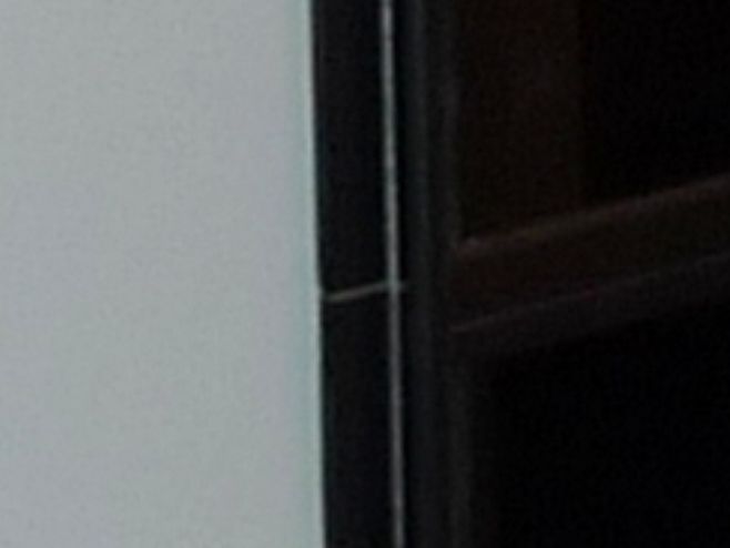

Also there is a seam in the metal frame of the doors in the same place as the gap in the seal. I found a pic I took during my build that kinda shows the gap. You can see the seam in the frame and a little indention where the gap in the seal is. I made sure I put silicone in the metal seam as well.
