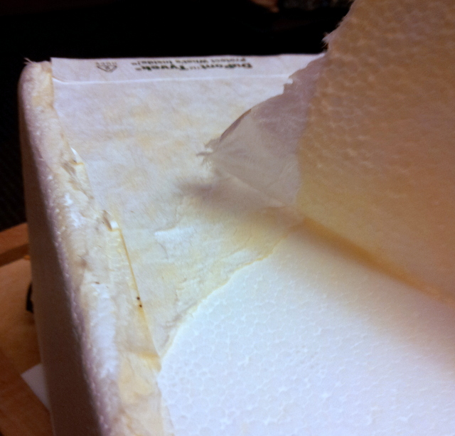

I"m doing a test right now -- gluing a Tyvek mail envelope to a styrofoam cooler with ProBond glue. You might expect a report sometime tomorrow.

Uh-oh, I spread PL brand, not ProBond as I reported before. I spread a pretty thin coat on the styrofoam, and it bled through a little bit through the Tyvek. But so far, it hasn't foamed at all after 4 hrs. I'll post a pic soon.

Postby Bob Hammond » Tue Oct 01, 2013 7:42 am
The PL Premium glue worked well. In a tear-off test, the glue bonded the Tyvek tightly enough so that it delaminated. The glue gripped the stryofoam very tightly as well, such that bits of foam were torn out too.
But as Grant(?) said, the PL glue is sticky to work with, and so I'll try Titebond III next which is supposed waterproof. While on the subject, I wonder if it would be a good idea to have a few removable insulation panels, so that when the camper is in storage, water vapor could pass through the Tyvek skin so as to keep the interior fresher.

Postby KCStudly » Tue Oct 01, 2013 3:38 pm
Did it actually pull the foam or just the imprint in the glue?
Re: Tyvek over foam, applied with polyurethane glue?
Postby Bob Hammond » Tue Oct 01, 2013 4:09 pm
It's a little hard to tell, but mostly it looks as though it pulled away although there are definitely flecks of foam attached. I'd say that it's essentially a mechanical bond to the foam, but acceptable I think. They PL glue definitely penetrated into the Tyvek. It's seems to have a bit of a stink, at this time. I wonder how soon that will dissipate.
