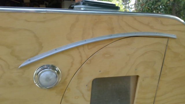

It is a problem that most of the extrusions available here are very stiff. I recently had a lot of trouble bending a J shape as a gutter over a door.
I like the marker pen system... I will give it a try. I did read somewhere of a similar system using soap as a tell-tale. Just rub ordinary hard soap on the job then hit with the gas torch until the soap turns black.. then STOP! I tried this and it worked well. I also experimented with applying a little more heat after the black appeared and it was not long before the aluminium failed dramatically.
I eventually got the arch I wanted using some bending rollers but I think this was the limit without annealing. The roof corner trim on the other hand was nice and soft and was extremely easy.
