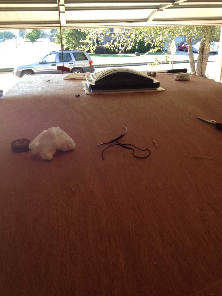

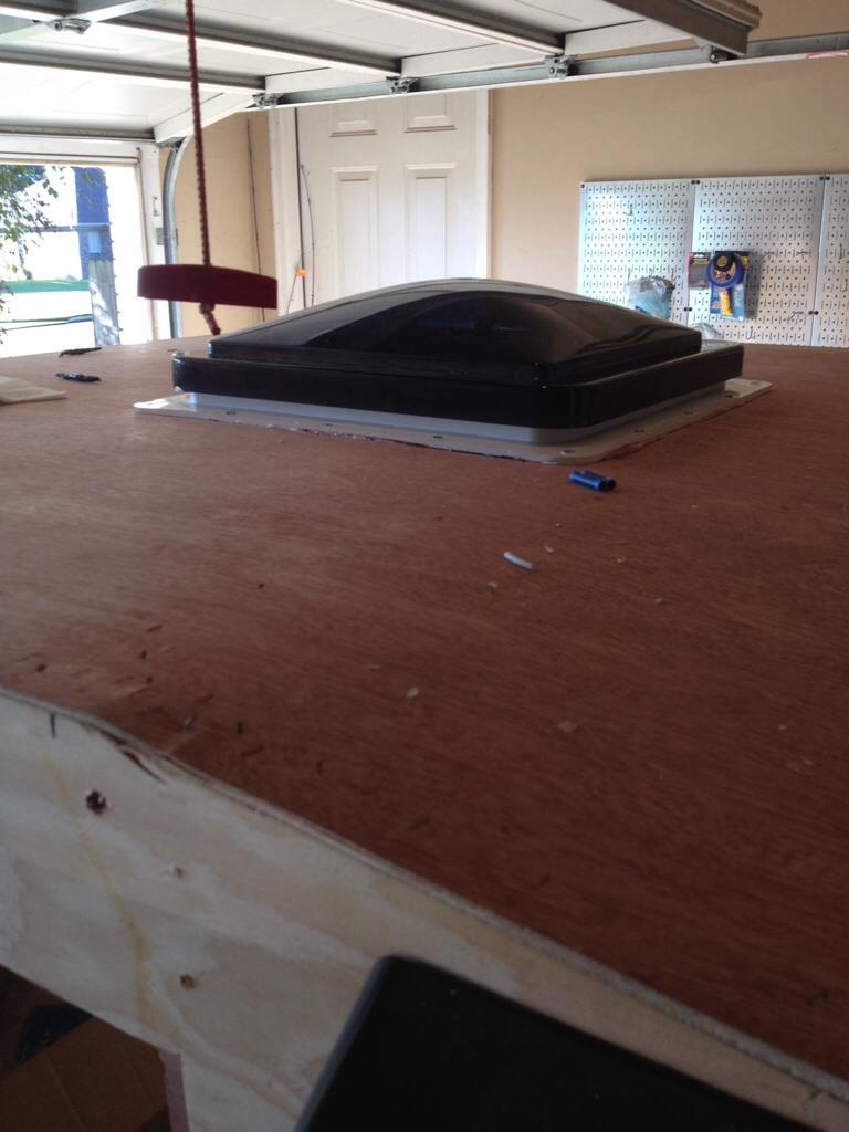

I am closing in on being finished with my Benroy. Seems like it's been a long 4-5 months.
I'm posting a few pics as I'm proud of the work I've done. This is the first time I've built anything pretty much!
Anyways a carpenter friend of mine said that the Luan roof on my camper will fall apart in the first rain or even a heavy dew!
Is that right? What do I need to do to protect the top?

Any wood will deteriorate in the rain. regular plywood probably even worse, marine grade plywood less.
At a minimum you need to seal and paint it. For a woody, you would clear coat it.
At best you apply a finish over the top of it, like an aluminum skin.

It will start to delaminate in about 10 to 20 minutes in the rain! Get some epoxy on it and then at least some paint and get it well sealed. Anywhere that your plywood isn't protected or anywhere that water can get in, it is definitely liable to delaminate. Some luan is worse than other luan, depending on the quality of the glues; but, you can't leave it bare like that.
