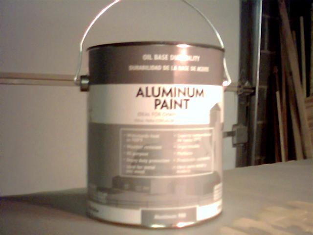

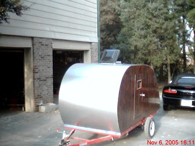

Well a week goes by and many hours of using a putty knife and sander has lead me to a finish that I really like. The short of it is this. removed old crappy paint, re-primed, sanded some more, wiped down and used a paint simaliar to what Loader found at Lowe's web site. :shake hands:
First here is the paint.
Then the paint on the top.

Postby madjack » Sun Nov 06, 2005 8:41 pm
sure hope it works this time...I sure as heck know you do too

Postby Hardin Valley Magic » Sun Nov 06, 2005 8:44 pm
thanks me too. painted it at 12:00 noon today Sunday and by 4:00 it was totally dry.. ;)

Postby madjack » Sun Nov 06, 2005 9:03 pm
Hardin Valley Magic wrote:thanks me too. painted it at 12:00 noon today Sunday and by 4:00 it was totally dry.. ;)
that sounds good, I had gone and looked up several types of that paint and their msds and use sheets and they said 3/4 hrs of drying time, so it looks like ya got the right stuff this time...keep us informed on how it works out

After your first post I found some aluminum paint on a close out (one hour dry time). Couldn't resist (cheap). What did you use to skin the top with?

Postby Hardin Valley Magic » Mon Nov 07, 2005 4:45 pm
Joamon: i used luan as an outside skin then primed with oil based zinsser stain sealer/ primer 2 coats sand between and after. Then tack cloth wipe down. I used a foam roller with the paint but, (helpful note): keep a small sponge brush handy to wipe out air pockets that form then roll over it again.
This paint wasn't as reflective as the other but hey, this paint actually worked. :lol:

Postby dskentfield » Tue Nov 15, 2005 8:48 pm
Are you saying the top is painted luan?????
WOW!!!!!! :applause: :applause: :applause: :applause: :applause:
What is the brand name of the paint??

Yup painted luan 5.2 The paint is sold at Lowe's. I found in the paint section for BARN AND FENCES. :thumbsup:
