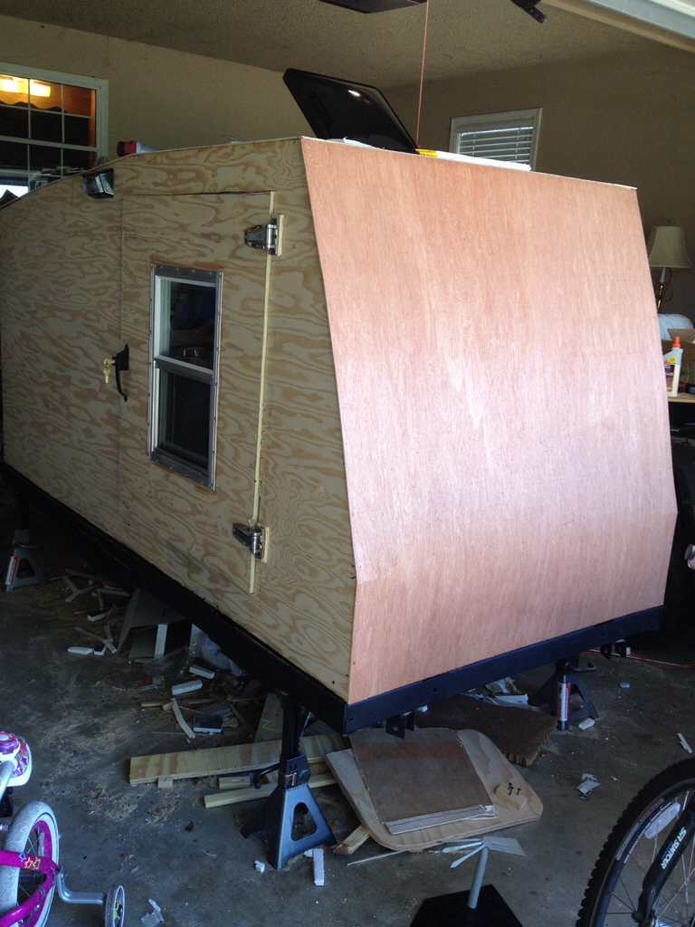

I posted a question about trim but I think my question goes deeper than that...
Do I need to first apply epoxy. Then paint. Then apply some sort of waterproof tape at the seams and stick the trim to that?
Here is a picture of my camper so far. I need trim or water protection where the front wall meets the roof and where the side walls meet the roof?
I'm a newbie so please don't skip any steps because I've never built anything before. Thanks.

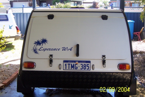

Tscar,
Caravan joint/edge rubber seal.
The tear is clad in steel and alloy diamond pattern on the bottom sections.
RD
