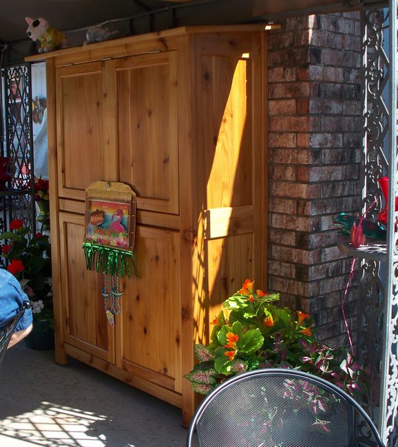

You can do what you want but this outside TV cabinet I built is in its second year and still looks new, coated with 4 coats of Helmsmans spar urethane...
They remove the shade-ezup during the winter..

That outdoor piece of furniture that Oak Ineriors posted is an outstanding piece of work. Gorgeous! It appears that it's made from cedar. Most plywoods with some way of intaking moisture will delaminate over time. As you are well aware, you've got an incredible amount of time in your build and a fair amount of money.
