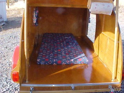

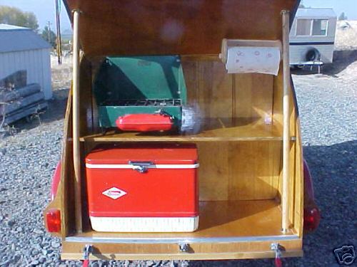

p.s. Here's my TD with the galley popped out so you can see what I'm starting with.

Can you post pics of the ceiling inside? That would help alot. Foil-bubble-Foil insulation looks like the space blanket that has been around for years. Home Depot and Lowes both sell the stuff (at least here). It is only 1/4" or so thick and can be stapled or glued in place. Also, it can be cut with a pair of scissors! Nice tear, from what I could see. Where did you get it and what does the galley look like when in?

TOYPUSHER: This really nice guy named Clint who used to be a millwright who lives in Klamath Falls, OR built the TD. The galley is just a shelf so far but I plan to add a rolling shelf for my cooler and a few cupboards for pots, etc. I have MANY, MANY galley ideas from looking at all the diff TDs out there! :)
I don't have a picture of the inside roof yet becuase I don't have the TD in my own possession yet. I put the pics Clint sent me in my personal galley. I may have to "re-ask" this question when I have more pics!
