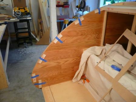

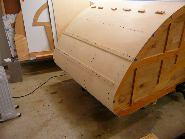

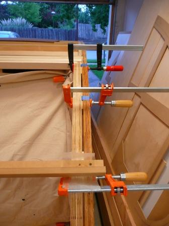

I built the framework and skinned the outside of my hatch in place, but I did not have to cut it loose. The way I did this was to have a framed bulkhead - later to be insulated and skinned both sides - instead of a solid plywood bulkhead. I used screws and spacers to temporarily attach the framing. I also waited to cut the "notch" for hatch/sidewall weatherstripping until after the hatch was built. I "released" the hatch by crawling from the cabin through the bulkhead framing into the galley area and then removed the temporary screws. Here are a few pictures:
