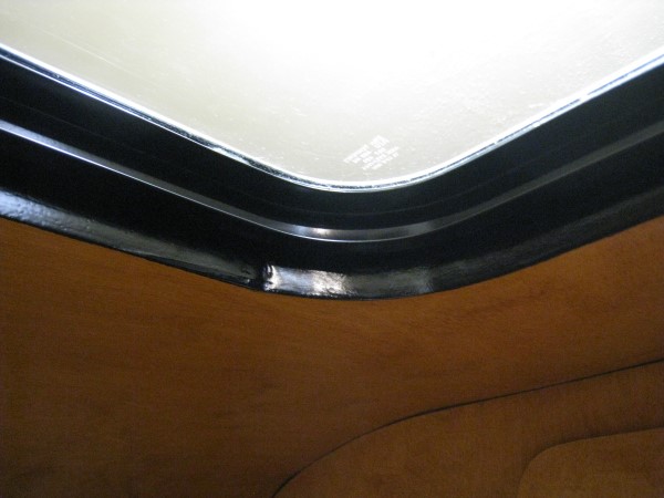

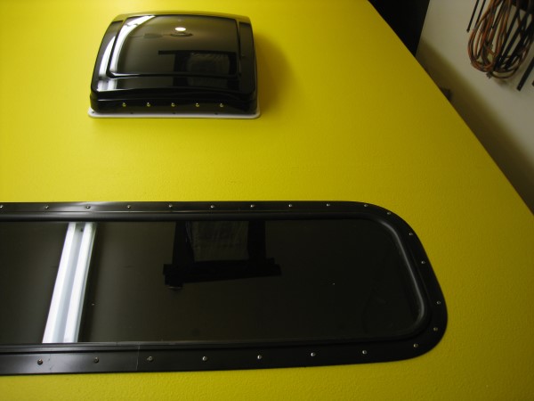

I bought my moon roof off ebay and it came with trim ring but my roof was too thick and it wouldn't work. I drilled holes through the aluminum outer ring and screwed it into the roof spars through a layer of Butyl tape
I painted the windows opening black to match the color of the windows so it blended in as shown in the picture from inside my teardrop. I finished the opening edges and use an epoxy filler to make it smooth for the paint, so it looked more finished.
Here is a view from the outside showing the 1" stainless steel pan head screws around the outside lip

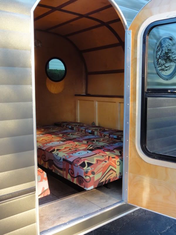

While the trim ring look is preferred, not all trim rings fit every thickness of walls. So you need to be sure, even if a trim ring is supplied it will work with a 3/4" wall, or whatever you are using. The only time I used that kind of window, there was no trim ring. I made my cut out for the window as perfect as I could so. In this picture, you can see that I made a trim ring from 1/4" plywood to cover the inside and dress up the window. The round window inside was without a trim ring because it looked fine without. I did screw the windows on the outside trim ring with black screws.
