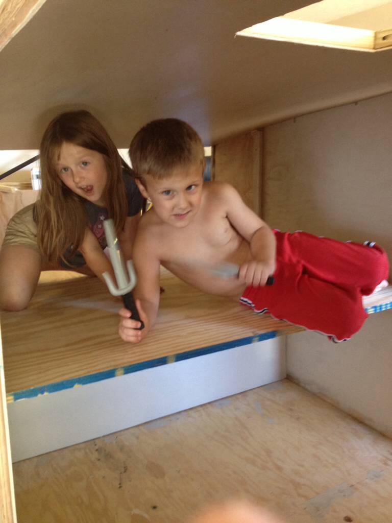

Thought I had a better picture, but here's my interior shelf/bunk. I built it this way for my (ex)girlfriend's son. The 2 rails are removable - they just lift out of place. There was a foam pad that was on the shelf when he slept up there. Now that the gf and her son are no longer in the picture, its a great place to put dufflebags and clothes. The end supports are just pieces of inside corner trim mitered to form a cup. The shelf itself is 3/4" plywood, which has a 1x2 running from side to side across the 5' wide cabin for support. It easily holds 150+lbs.
The lack of cabinets is a lot more versatile, allows for more gear/clothes, and also gives the cabin a more open feel. I'll never have interior cabinets in any teardrop I build. They look nice and pretty, but I feel they add weight and take up space. Just my opinion though.

Well, It is an oak 1x2, which is a bit harder and stronger than pine. But a 2x2 would probably work too.

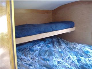

I built an extra big shelf I accommodate my 6 yo twins. Hope you can see it from this pic.
I installed a lip on the edge to keep them from rolling off onto me.

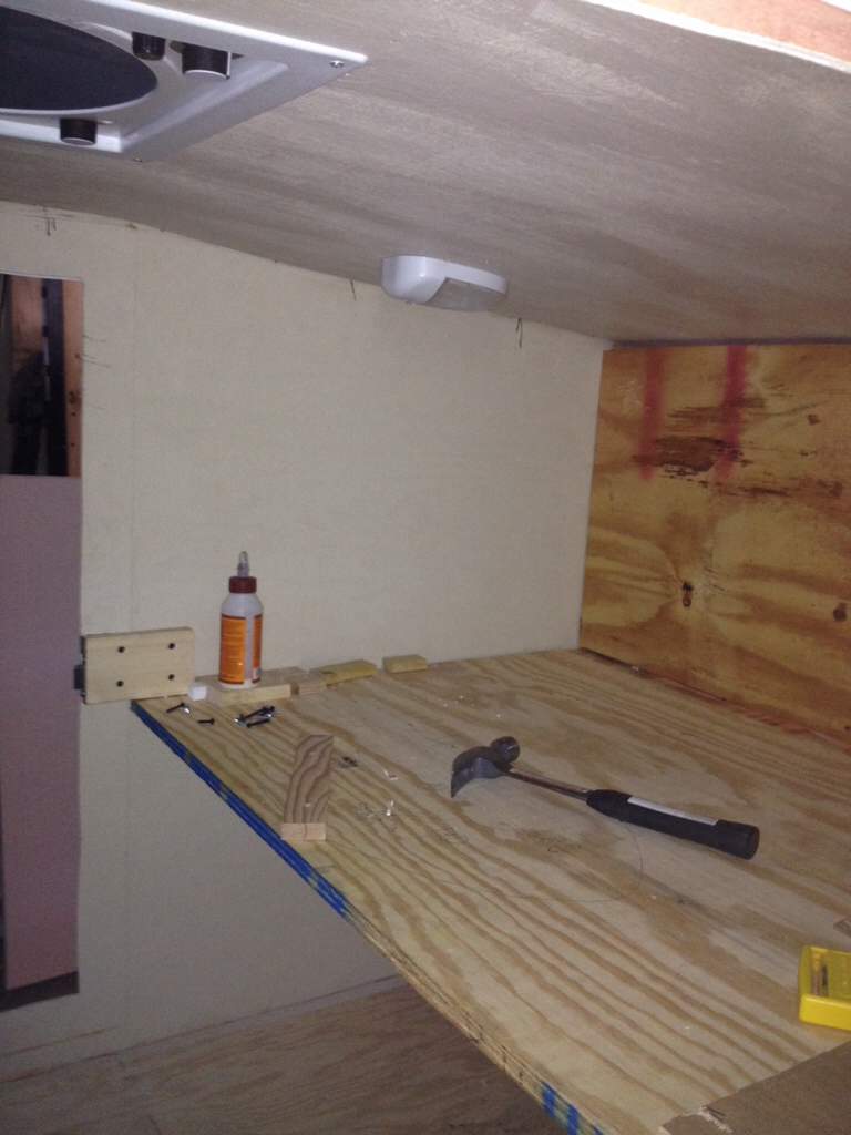

This is one of the best examples of a home-built bunk that I’ve seen:

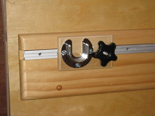

Here is a good picture of the purchased hardware for the above bunk:

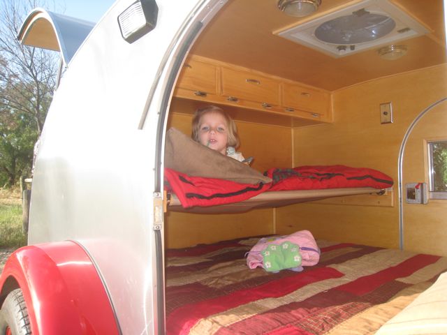

This one (Megadrop) is not a teardrop but rather, a ttt with a lifting roof; but, in this picture, you can kind of see how these bunks were done:

There are bunks out there. You just have to do a few searches to see them.

The removable cot idea is really good... :thumbsup:

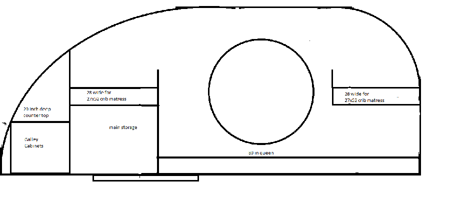

Just made a rough sketch of my 5x 10 with a double bunk thought it might be appropriate for this thread. The bunks will be about 28 in wide and the length of the trailer (5 ft minus walls about 4 in for walls) so I can drop some old crib mattresses in them (27x52). Should be great for the little ones until they get not so little.
