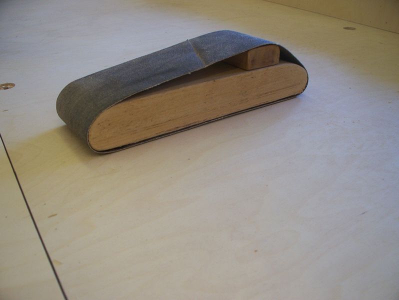

Most of my woodworking involves the use of my 3 inch belt sander. However, when confronted with sanding members flush with thin, faces of finish plywood, my wonderful powerful sander is often much too aggressive. Therefore, I have found that cutting a 3/4 inch wooden block the width of my standard power sander belts, and inserting it within an old sanding belt, gives me the control of moderate, non-aggressive flush sanding, without the danger of damaging the adjacent surfaces.
I simply make the insert the same witdth as the sanding belt, and slightly shorter than the interior of the belt. I then slip in a thin wooden wedge at the end of the belt and use this two-sided sanding block, as a much better controlled method of getting the job done. It is much less aggressive, and I find that it is a much better method to maintain a more controllable sanding conditon, since you don't have to wait to lift the belt sander, to see how much damage has been done by that aggressive monster, hidden below the grits of the belt. Just a thought

Roly Nelson wrote:Most of my woodworking involves the use of my 3 inch belt sander. However, when confronted with sanding members flush with thin, faces of finish plywood, my wonderful powerful sander is often much too aggressive. Therefore, I have found that cutting a 3/4 inch wooden block the width of my standard power sander belts, and inserting it within an old sanding belt, gives me the control of moderate, non-aggressive flush sanding, without the danger of damaging the adjacent surfaces.
Roly 8) .
Like this...Image
