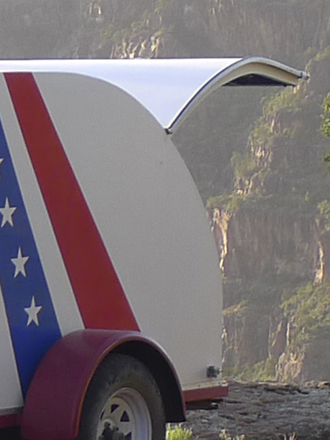

Postby ssample » Sun Dec 29, 2013 7:19 pm
Thanks for the quick reply. I am studying the calculations in the Excel spreadsheet within the limitations of my dimensions and have some questions?
How did you arrive at the 60% ideal gas spring length percentage? This is about the size of extended gas spring that I can get into my TT above the galley counter.
Also, how did you determine that the ideal hatch attachment point should be 85% of the gas spring stroke length?
Finally, I did not understand that the attachment point inside the galley should be placed along a radius measurement from the (hatch) hinge center point equal to the extended length of the gas spring. This might work on the configuration in the hatch and galley layout that you show in the diagram that you provided in the post; but in my TT, the gas spring will be installed nearer to vertical and the extended gas spring hatch attachment location will be about 8 inches above the hatch hinge point with the hatch fully open. For now I have attached a photo crop that shows my configuration to help explain my situation and to assist you.
Thanks for your assistance. Steve

Postby danlott » Mon Dec 30, 2013 3:16 am
I got the ideal length, mounting locations and calculations from various strut manufactures websites. All I did was try and make sense of the calculations and show how to apply the information to teardrop hatches.
You can go with shorter struts than the ideal length struts. This will require different mounting locations and higher strength struts to be used. This will also not support your hatch as well at the ideal length struts would. I also believe the higher strength struts will place more stress of the hatch hinge. As far as I can tell lots of people have used smaller struts and have had no issues.
The ideal mounting locations are to try and prevent the strut from compressing more than 85%. This again was found on the various manufactures websites.
As I stated in the spreadsheet it may not be possible to use the ideal length sturts due to the design of your trailer. You may very well have to use smaller struts to fit your design.
The calculator determines the force required for each strut. Make sure to put the number of struts that you will be using in the right box.
Hope this makes a little more sense now.
