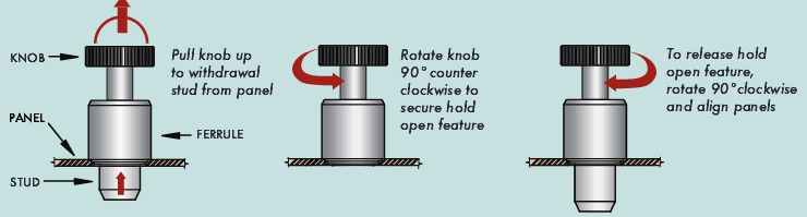

Postby mbstonegate » Thu Feb 27, 2014 1:52 pm
How about using a “spring-loaded captive sliding door plunger”? That’s one of the names the part goes by, sometimes called a spring loaded plunger. There are different styles, colors, and sizes available.
It’s similar to the hole and pin method, but no parts to lose as it would mount to the door.
The diagram shows how it works…
spring-loaded captive sliding door plungers.jpg (55.83 KiB) Viewed 563 times
Manufacturer link to get a better idea of what they look like…. http://www.southco.com/en-ca/56
