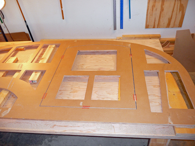

I have gotten to the point where I need to do work on the walls. In the past I have used saw horses and other tables to do my work but this build makes me wonder what others use.
I am looking for a better idea.

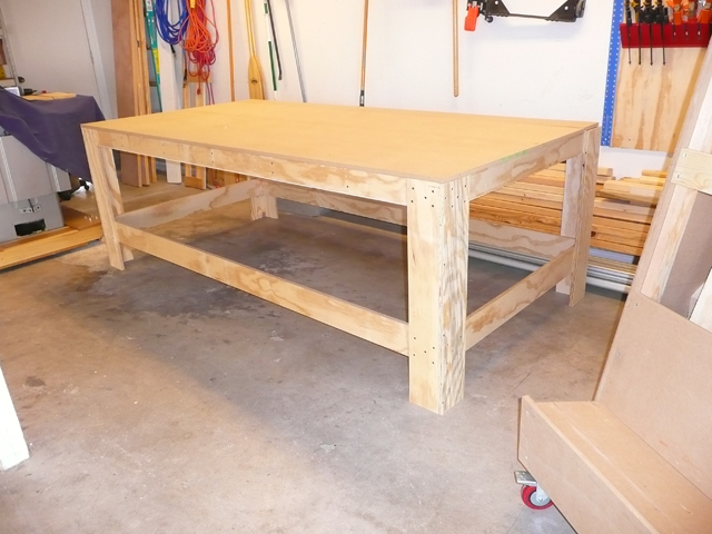

For my build, I made an oversized assembly table based upon a version of Norm Abram's Work Table: http://www.newyankee.com/index.php?id=53#!/~/product/id=7916621.
Here's a picture of it before the top:
The base for the top is a 4' x 8' torsion box. To it, I added a 5' x 9' top of 3/4" plywood. The 6" overhang all around provided room for clamps. The legs are made of 3/4" plywood and are fastened to the torsion box with drywall screws.
I don't have a finished picture of the table but you can get an idea of the design from this in-progress construction picture:

I really like that table Tom! Did you use plywood for the legs and sides, or did you use dimensional lumber? Oh no, another project! :?

RandyG wrote:I really like that table Tom! Did you use plywood for the legs and sides, or did you use dimensional lumber? Oh no, another project! :?
Randy,
The "innards" of the torsion box table is made from a 1' grid of 3/4" plywood ripped to a thickness of 4". The perimeter is also 3/4" ply. The bottom skin is 1/2" ply and the top of the torsion box. The legs and stretchers are 6" strips of 3/4" plywood.
