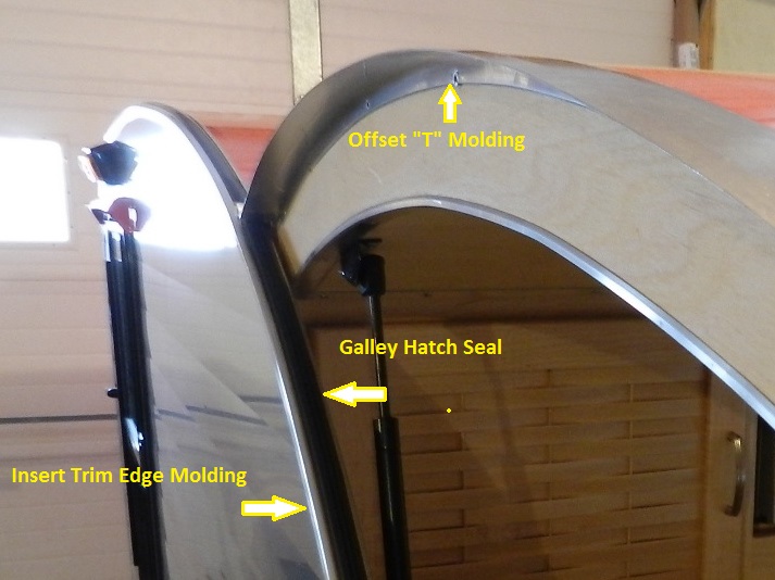

Hello all. I am planning on using the insert type roof edge trim and offset T-molding method of sealing a galley that Vintage Technologies uses. Has anyone else used this method. My question is how much do I need to notch my galley side wall to account for the space of the roof edge trim and the seal.

I used the same insert and T moldings from Vintage Technologies on mine. You do not have to notch the side wall at all. That's the advantage of that molding. If you look at the picture you posted, you can tell the side wall isn't notched.

The vinyl insert isn't used as a seal. They have a neoprene insert for the trim that's used to seal the hatch.

It has sealed up my hatch really well. Only problem I've had was a small gap towards the bottom of my hatch. I don't know if it was spring back or if I didn't cut the ribs correctly, probably the later. I just added some thick weather stripping to the T molding, and it's worked great. The hinge is important as well. I have the NON offset hurricane hinge.
Here's pic of the seal it makes.

Yes, I believe you have it right. These are what I used on my galley:
This hinge
http://teardroptrailerparts.com/Hurricane_Hinge.html
This T trim on the hatch
http://teardroptrailerparts.com/Offset_T_Molding.html
This Insert Type Roof Edge Molding on the walls
http://teardroptrailerparts.com/Hinges___Aluminum_Trim.html
This insert in the edge trim
http://teardroptrailerparts.com/Neopr_Galley_Hatch_Seal.html
Here's some good pictures from Frank's website that show the set up
