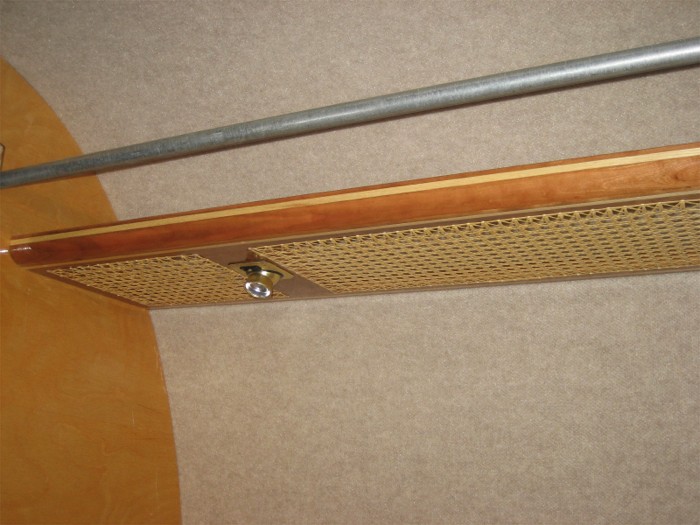

A number of people have used marine hull liner material from YourAutoTrim. I had good experience with the people from YourAutoTrim who were very helpful and did a quick shipment. The hull liner itself goes in real easy (but I glued it on the flat). You only need to make sure you use the right spray contact adhesive. This is how it looks as a headliner in my trailer.
