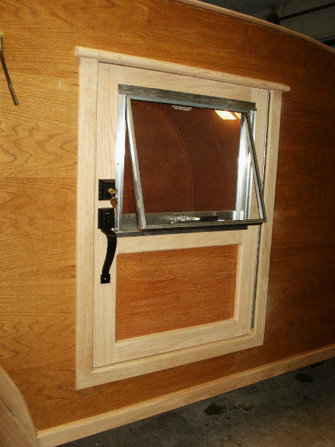

Postby Steve_Cox » Thu Nov 17, 2005 9:55 pm
Finished building my doors yesterday. Started out thinking I would do the somewhat standard 1 by lumber frame with insulation sandwiched between 1/4" plywood skins. But as I was building the frame out of oak, it came to me to put the frame on the exterior since I'm building a woody. There are 2 layers of 1/4" oak plywood behind the frame, one facing out and the other facing inward. No insulation in the door, but I like the look. Doors are about 1 1/4" thick. Windows from Grant. Latch and deadbolt from Lowe's.

Postby Hardin Valley Magic » Thu Nov 17, 2005 10:03 pm
Hey Steve that looks great I really like the trim around the door and bottom.. :thumbsup: Thought of adding something like that to break up the sides. :thinking:

Postby madjack » Thu Nov 17, 2005 10:17 pm
Looks pretty damn good to me buddy...The "panel" door really adds to the woody look :thumbsup: :applause:

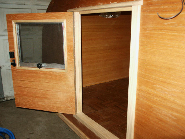

Nice job, I like the look of your door handles. Can you post a shot with the door open?

Postby Steve_Cox » Thu Nov 17, 2005 10:51 pm
DHAZARD wrote:Nice job, I like the look of your door handles. Can you post a shot with the door open?
Went out and took a picture for you. Thanks guys for the kind words, and Chris can you change your avatar? You're scaring my cat.. :lol:
