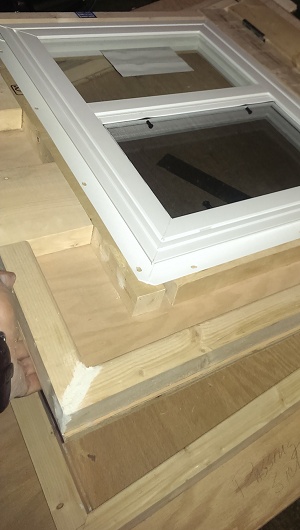

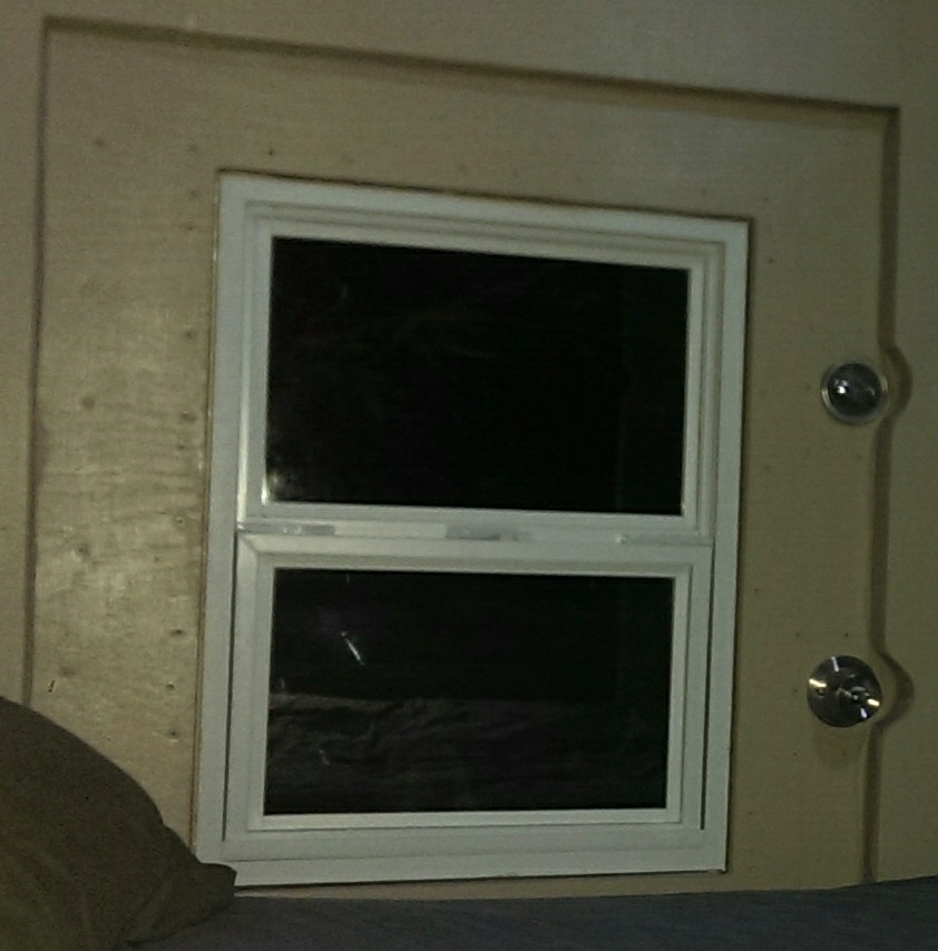

I'm new to this, the site and building. I saw your window from Lowe's and its the same one I am using. This is the door I built for it. Basically, I took a 4x4 sheet of 1/2 inch ply and centered the window. Cut a hole for it and lined the opening with 2x2s. Then, I cut out the door to created a frame and door from the original plywood . Lined the door and the frame with 2x2s to create a sill all the way around using 2x4s for the hinge side. The door isn't finished just yet. I'm planning on covering it with 1/2in and building a frame around the opening with the same to fill in the remaining gap. The opening of the door is 34x30. When I cut the door opening in the wall I plan on making it an inch smaller on all sides. (the hole will be 32x28.) This lip will be where my weather stripping will go. Thought it was funny, two SC folks building the same thing with the same stuff at the same time. Small world.

Another concern with these windows is weight. The little trailer windows are quite light weight so it doesn't add much to the door or trailer overall weight; makes it easy on your hinges. As mentioned, those windows are designed to fit into a house so they are quite substantial perhaps, overkill for a little trailer. Finishing will be much more of a challenge for sure.
The reason most go with trailer windows is that they are designed to work with the requirements of travel, wind, rain and weight. Of course the bottom line is, it's your trailer, build what you like. For me, I asked myself meany times on my build, 'is it worth the money?' My answer was almost always that I didn't want to say, I wish I had..., later on.

Trying not to rain on your parade, but I agree with the others. House windows are both under and over enginerred for your little trailer. Heavy and try to deal with the gap a and a wall not nearly thick enough will require.a very thick door.

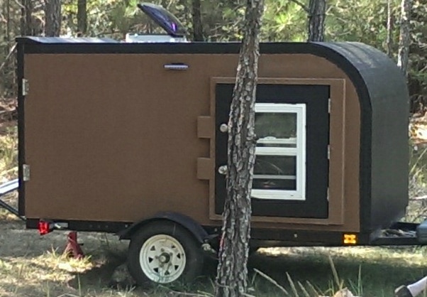

Postby lastrom1 » Tue Oct 21, 2014 10:15 am
The finished product.
