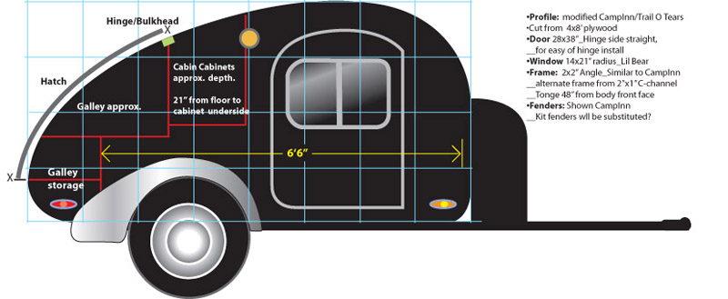

Postby norm perkiss » Fri Dec 02, 2005 9:42 pm
Roberto,
I have been working on a design based on the CampInn. It's not an exact profile but pretty close. The internal divisions of space are my own guest-ta-met. You can order complete doors with templates from CampInn.
It will be cut from a 4x8' sheet of ply. It is 8' long minus a smidge.
Norm
