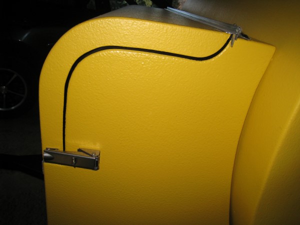

Postby AlgoDan » Tue Apr 22, 2014 5:02 am
I went with 2 Stainless latches very secure and flush mounted. I believe they were $28.95 ea. at trailer.com.
103659
Here now but Camping later.............Dan

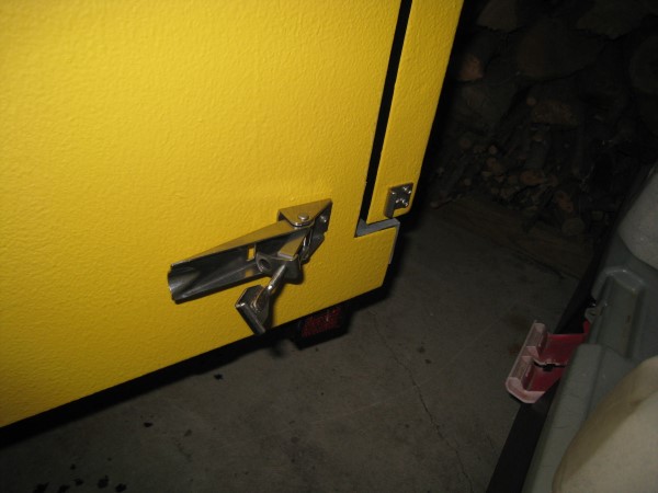

Postby Esteban » Tue Apr 22, 2014 11:06 am
I will be using two Southco locking draw latches. Part #v7-20-111-20. I just bought them from All-West in Seattle, WA for $31 each. Phone 1-800-676-1875. www.southco.com/V7-Over-Center-Series-Latches I may have paid too much.

Postby absolutsnwbrdr » Fri Apr 25, 2014 9:39 am
I used the draw latches that Steve mentioned. Southco V7 over center draw latches. They're pricey, but they're worth it. Stylish and lockable.
I have 4 extra (just like above but in satin chrome) if anybody is interested. :thinking:
