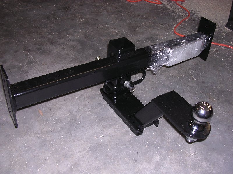

And I had a hitch fabbed locally for my miata. It is completely hidden unless it is in use. Receiver is vertical. I am sure it is over built. Here is a picture:

They did a clean job on it...I like the vertical receiver idea....I scratch built the hitch for the Rambler and now I'm thinking....If I get rear ended...I'll probably punch a hole in that 20 gallon tank! I might just put on a blunt plate on the end of the reciever....at any rate...the hitch looks great....Doug

That really is a GREAT hitch for the yada, if I had seen that before I bought the hard dog, thats the one id have!! :applause:
