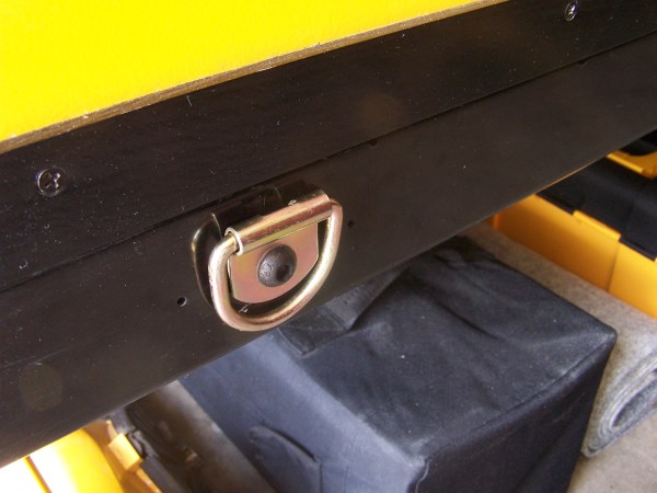

Postby les45 » Mon May 19, 2014 9:58 am
I installed several large D-rings along each side of my trailer frame. They lay flat when not in use and take up less space. These are quite useful for tying down a cover tarp when storing outdoors. I also use them to tie down one end of the EZ-up when camping (as an extra safety precaution against high wind).
