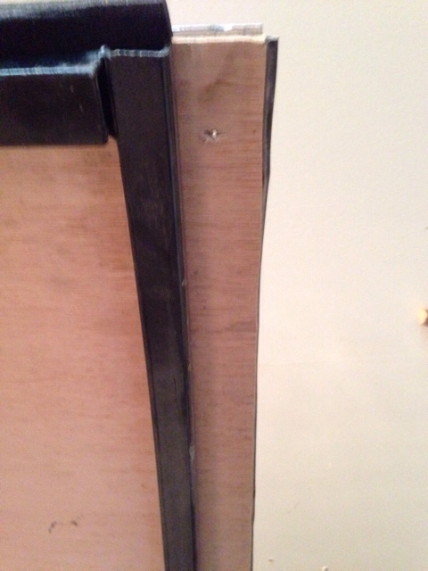

Here's photos of the underside of the hatch to show the overhang of the skin vs the hatch frame. One side has barely 3/4 of overhang and the other has over and inch.

Postby KCStudly » Fri May 30, 2014 9:00 am
I wouldn't worry about that too much so long as there is enough room for a gasket, the hatch does not wander from side to side when cycled up/down, and it is relatively flush (or has equal overhang) with the walls when closed (the later being an aesthetic concern).

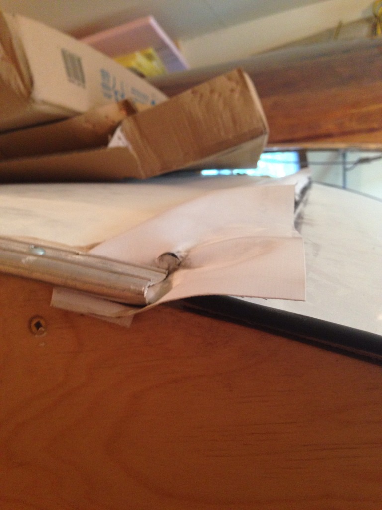

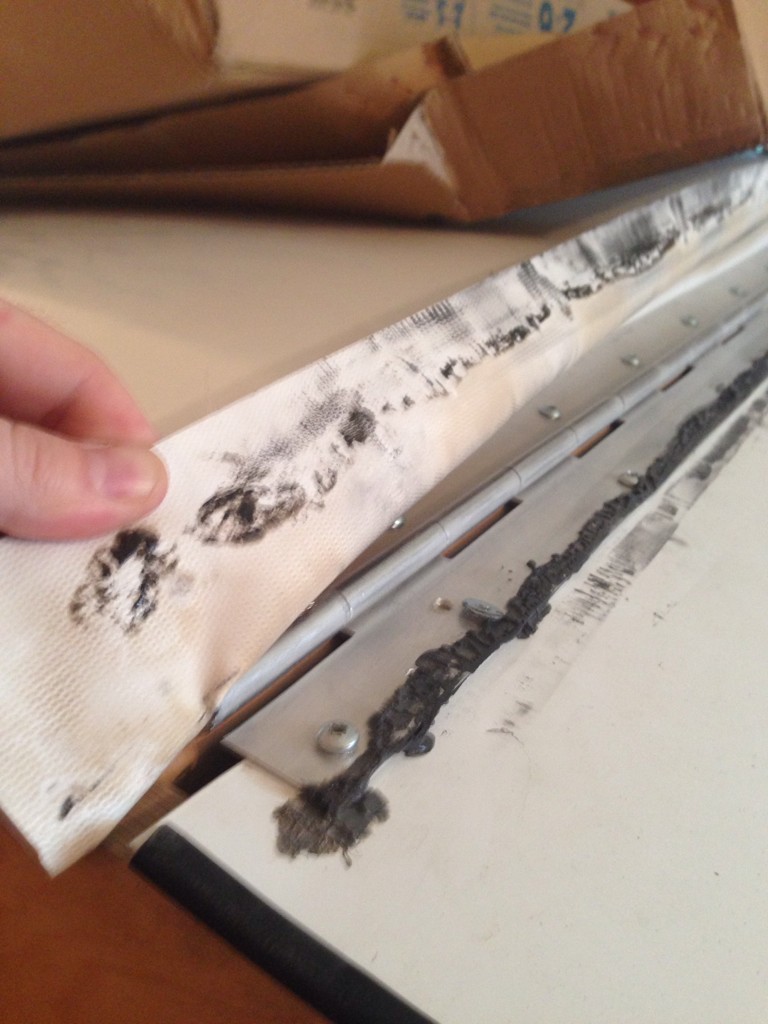

Thanks Danny and KC. This is good advice. I think given how it's built I won't be able to follow Danny's recommendation though I wish I could. The hatch is firmly locked into its shape from the steel frame and the way the skins were attached. It does open and close without any problems. It's mainly an issue of water tightness. Sealing the sides and figuring out the hinge.
Here is a couple photos of how the hinge is currently "not" sealed...
