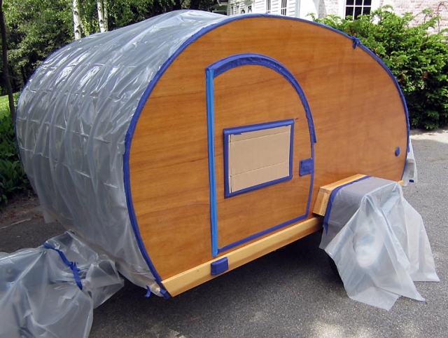

Now onto some pictures:

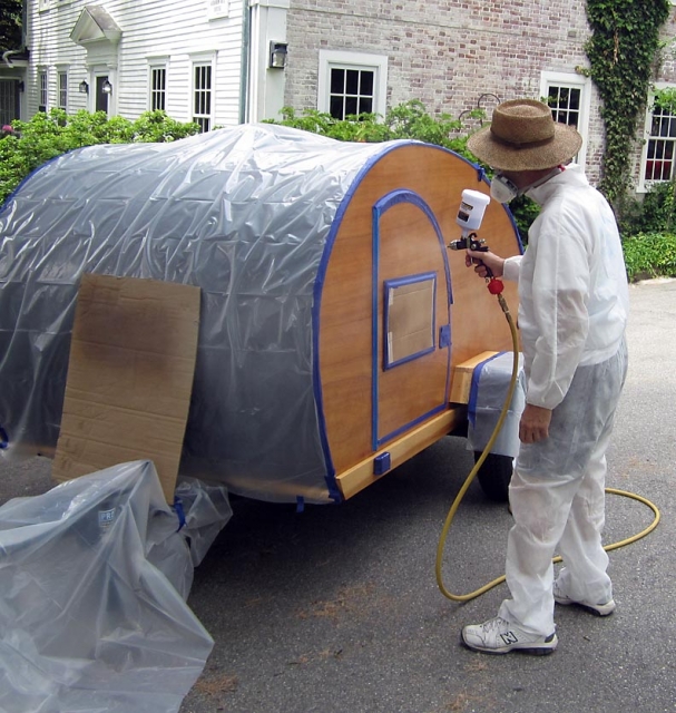

All masked and ready to be sprayed:

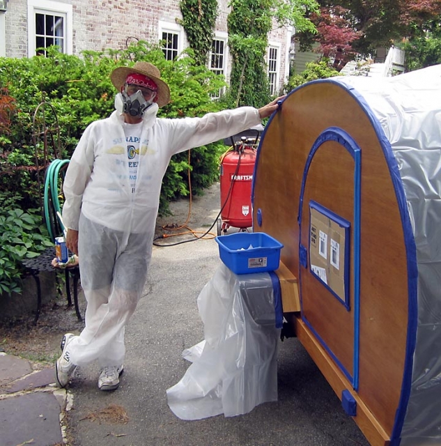

Me suited up and well protected:

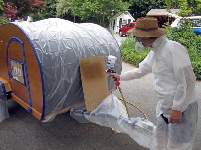

Checking sprayer adjustments on a piece of test cardboard:

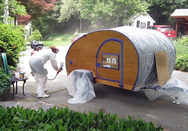

And finally spraying
In case you were wondering, I put 8oz (1 cup) of spar urethane in the sprayer cup and that was enough to spray each side twice (one coat). I'm waiting for the first coat to dry before applying another one. I'll try to take some picture of the final result, but from past experience it will be smooth and evenly coated without any brush marks or thick spots.

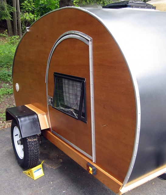

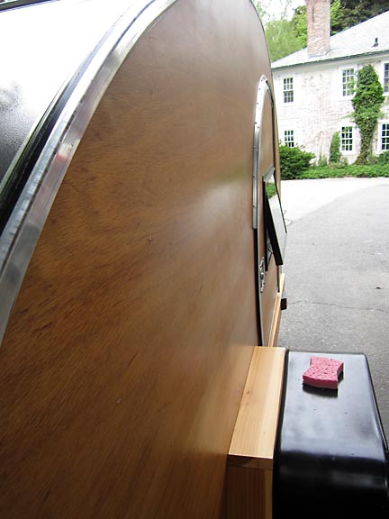

Results after a single/final coat
Postby jonw » Wed Jun 11, 2014 1:50 pm
Well, just as I was about to spray on a second coat a breeze came up and was blowing around thousand of these things:
Since the masking tape was peeling off I decided a single coat was going to have to do. Although another coat would have been nice the first coat was put on on two passes and coverage was pretty good, so it looks good and is well protected. There were a few of these fuzzy seeds stuck to the side in the urethane, but a quick light once-over with the scrubby side of a non-abrasive kitchen sponge (pictured below on the fender) removed them and any other imperfections without scratching the finish. You can see how smooth the finish is in the reflections.
The thing on the side in the middle of the picture is a bug *not* stuck in the finish - I guess he just wanted to be in the picture...
And here's the same side from another angle. The mark in front of the door was a gouge made by the open window before I put in a bungee chord stop. I filled it with wood filler (couldn't find mahogany color) before spraying and although it is noticeable it is now smooth. If you look real hard on the panel to the rear of the door you can see some of the original brush overlap marks, but they are hardly noticeable any more.
