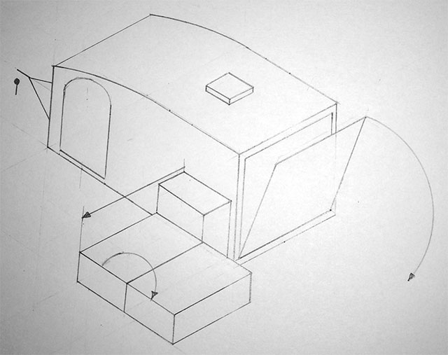

Hello chaps.
Rather than get in to the introductions forums, I'm diving into the deep end with Tilikum.
I want to be as aero dynamic and functional as possible, and originally I was thinking rimple shape.
So I saw a VIDEO of a cargo camper with a pull out kitchen,backgammon board style, to open up for more space.
The kitchen looks outta proportion at 2x2' on a 4x8' base.
I want to be able to put a motorcycle in the back, for club meets.
Would love some advice /input on my 1st draft sketch of my idea for a teardrop.
Afterthought, having the pull out kitchen to front with inside cabinets above would be a better use of space.
Thanks
Damien

Postby mezmo » Fri Jun 13, 2014 2:07 am
You could also have a fold-out kitchen area on/along the side,
oriented either vertically or horizonally, that would be 8-12 inches
deep and fold up into the trailer body to rest upright on it's end.
You can also mount an external fold-down table of aluminum or
stainless steel to the exterior wall like forum member titanpat57's
ROAM Camper build:
http://tnttt.com/viewtopic.php?f=39&t=42096&start=60
Here're some pics of the South African Jurgen Oryx Off Road Caravan:
Here are a couple pics of the Oryx:
The first with the fold up/in kitchen and fold-up table in travel mode:
121381
This Oryx shows the kitchen folded down and a couple
exterior access cupboards:
121380
You'd get the kitchen accessibility and also keep a nice amount of
interior space left for the motorcycle transport.
Here's a link to a camping dealer in South Africa [ZA] that shows
the Jurgen Safari line of camping caravans [TTs]. Both the Oryx
and The Xcape models have side fold-out-down kitchens.
http://bundugear.com/products/campertrailers.html
Cheers,
Norm/mezmo
